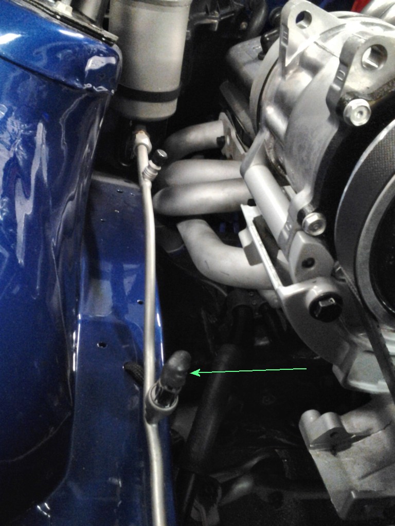

When the a/c as removed, a blue wire on the fan pressure switch needed to be grounded. its was part of a harness plug on the hard a/c line....
Can you tell me more about this wire,why you should ground it and what it does?

Originally Posted by keykey
Can you tell me more about this wire,why you should ground it and what it does?.
85-87, the a/c fan switch, shown above, was a ground input to the ecm. When the a/c was turned on, the switch opened at 'X' psi and the ecm turned the fan on. When the a/c switch is removed (or on a non-a/c car), the blue wire needed to be grounded to prevent the fan from running (open ground=a/c on).
88+, the fan request was reversed. The circuit is normally open and fan request is made by grounding the grey (iirc) wire.

Those look more like the plugs that went to your (probably) no longer present air pump diverter valves.
The fan pressure switch does not use that style weatherpack connector. The fan pressure switch looks like this.. http://www.wiringproducts.com/gm-a-c...tail-1-pc.html
