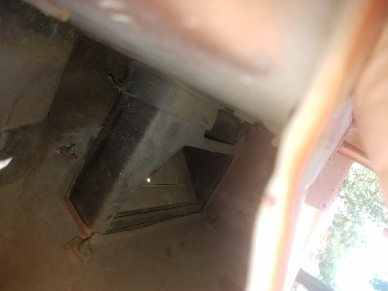

Thanks Aviator, awesome diagrams, I didn't even think to look for parts pictures. I figured there was a flap down there somewhere.
I started the car and ran it through max, and norm and vent. This flap didn't move from this position at all, and the air continued to blow out from the cowl. I guess there is an actuator somewhere and this foam may potentially be the problem, looks like I will be taking the dash apart afterall.

Of course these parts are not available new, the foam and rubber seals can be cut at home.
If you take it apart I would buy some foam stripping at hardware store as alot of the ducts use this at connections.
I suppose you Could pull that flap up manually with a strong magnet on a rope to see if it helps

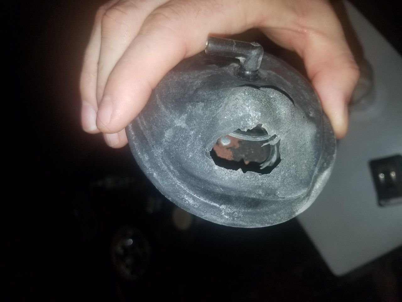

Thanks again for your help, found out the actuator you can get to from under the pass kick panel, comes out by loosening 2 10 mm nuts.
Do you think this has anything to do with it? The actuator I pulled out.
About 5 years ago when I was installing the sub frame connectors the interior caught fire. I put it out quickly with a fire extinguisher, but apparently this melted. I guess I have had a vacuum leak all these years. SMH
Thanks for your help, hopefully this permanently fixes it, now to find a new one.

Lol yep. eBay junkyard or Hawks is best bet. I think there are vacuum actuator rebuilders also.
