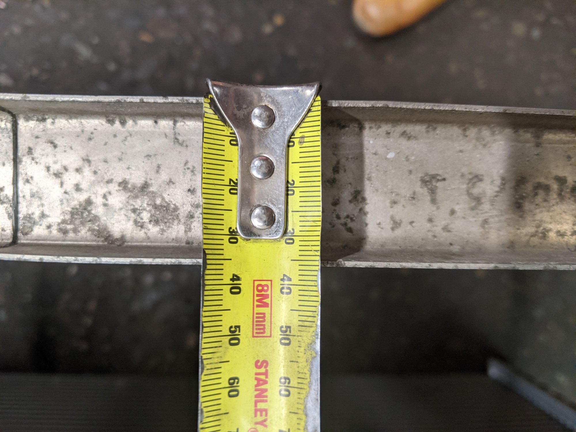

So the radiator has arrived, and hmmmmm.... It is a a whole 10mm thinner than the OEM one, is this like a V6 radiator? All the holes and patterns all line up ok. Would it be ok for a 5.7L 350? I will still keep the OEM Radiator in the hopes of getting the tanks fixed.

Old Mar 9, 2021 | 10:58 PM
