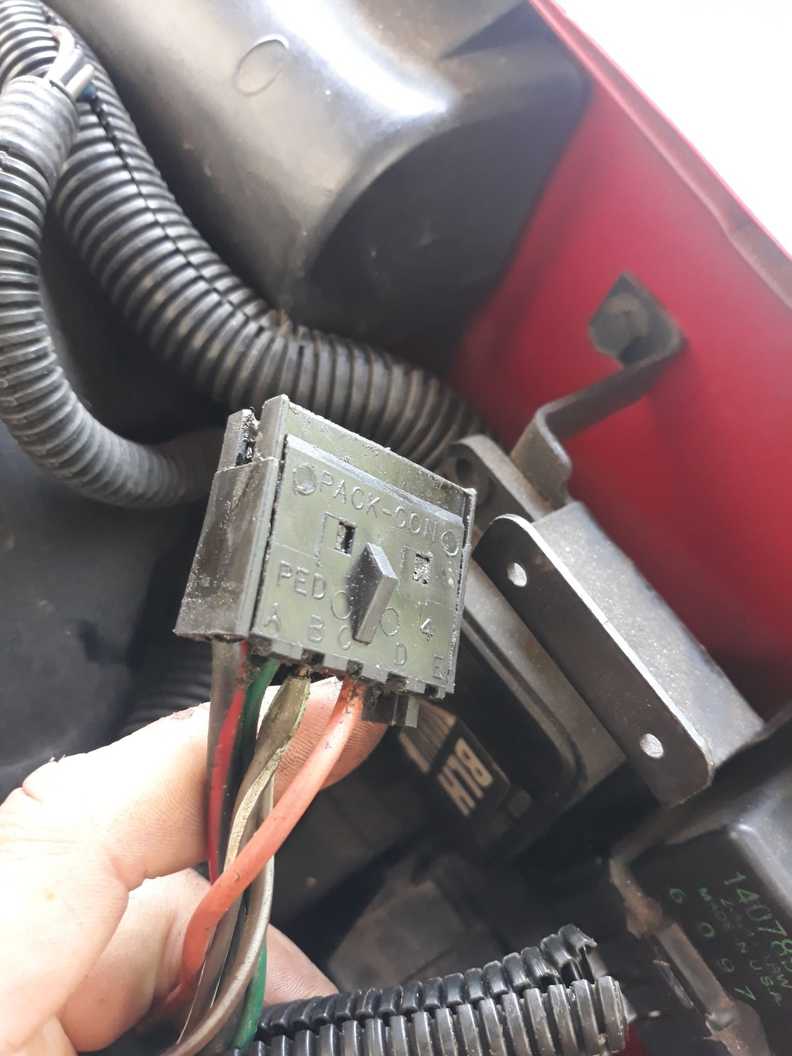

Re: Radiator Cooling Fan Not Coming On
This is what I'm looking for?
Originally Posted by MrCaswell
Does the switch ground via the threads?
Yes, it grounds via the threads, so if you put too much teflon tape in it it can;t ground.
That connector looks ok... but isn;t the cooling fan relay up front by the radiator area?
mine is right by the air box. 87 TPi Formula
That one you got might be for the fuel pump?
it looks similar if I am not mistaken.
Looks like the right 5 wires. Different years different locations and forms?
could be!
My cooling fan relay is by the air box but I also have a relay there that looks the same as the OP in the same area though.... Might be fuel pump but i have no clue lol
