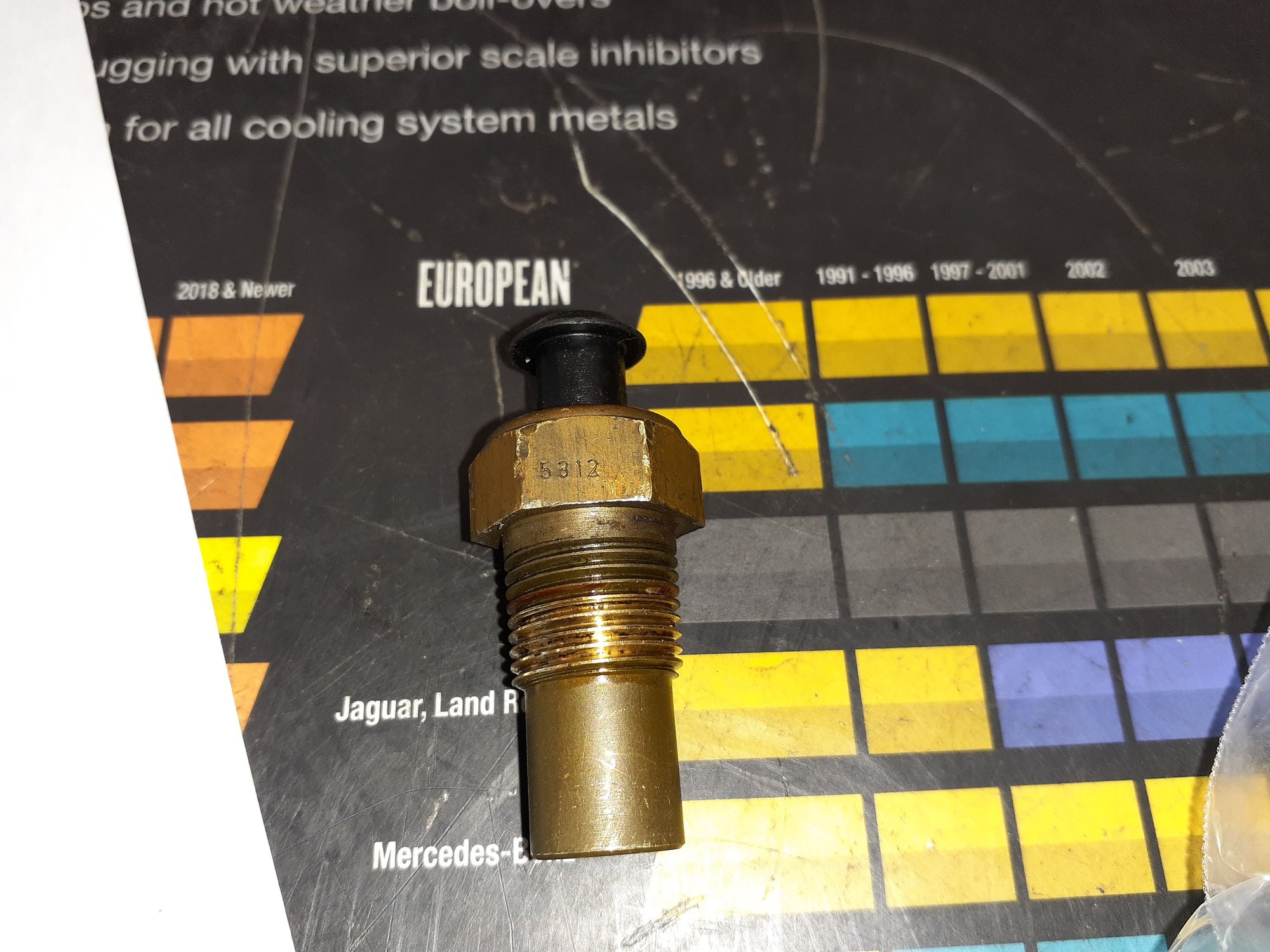

Thanks. I replaced both relays. Still nothing. Ordered coolant fan sensor that is between cylinders 6 and 8. Noticed the plug is burned. Also replaced high pressure ac switch and coolant temp sensor in front of engine.
Will let u know how it goes.
