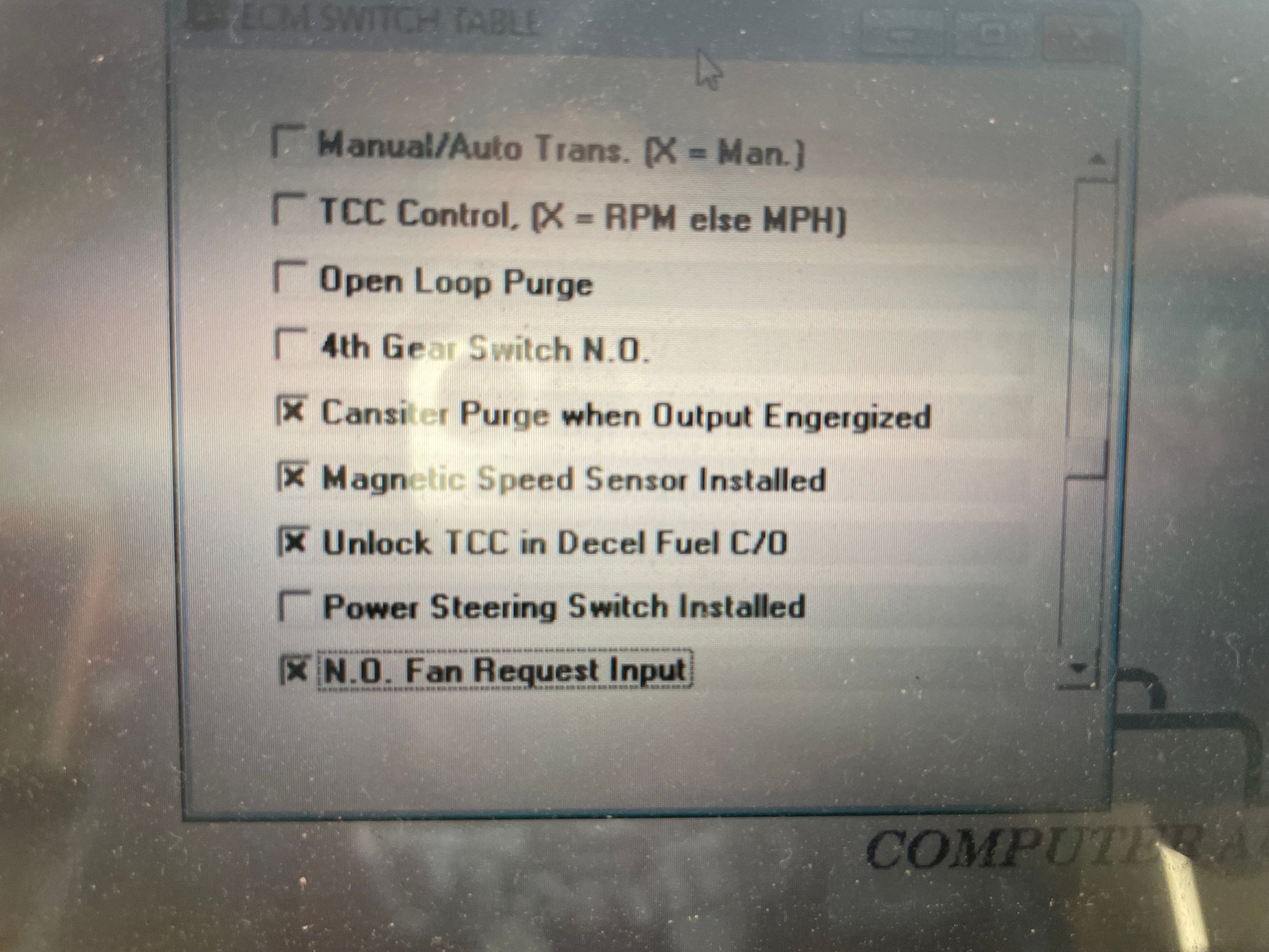

The drawing might be the confusion. Anjf aujp tunes have a n/o fan switch
Thanks alot for replying.
