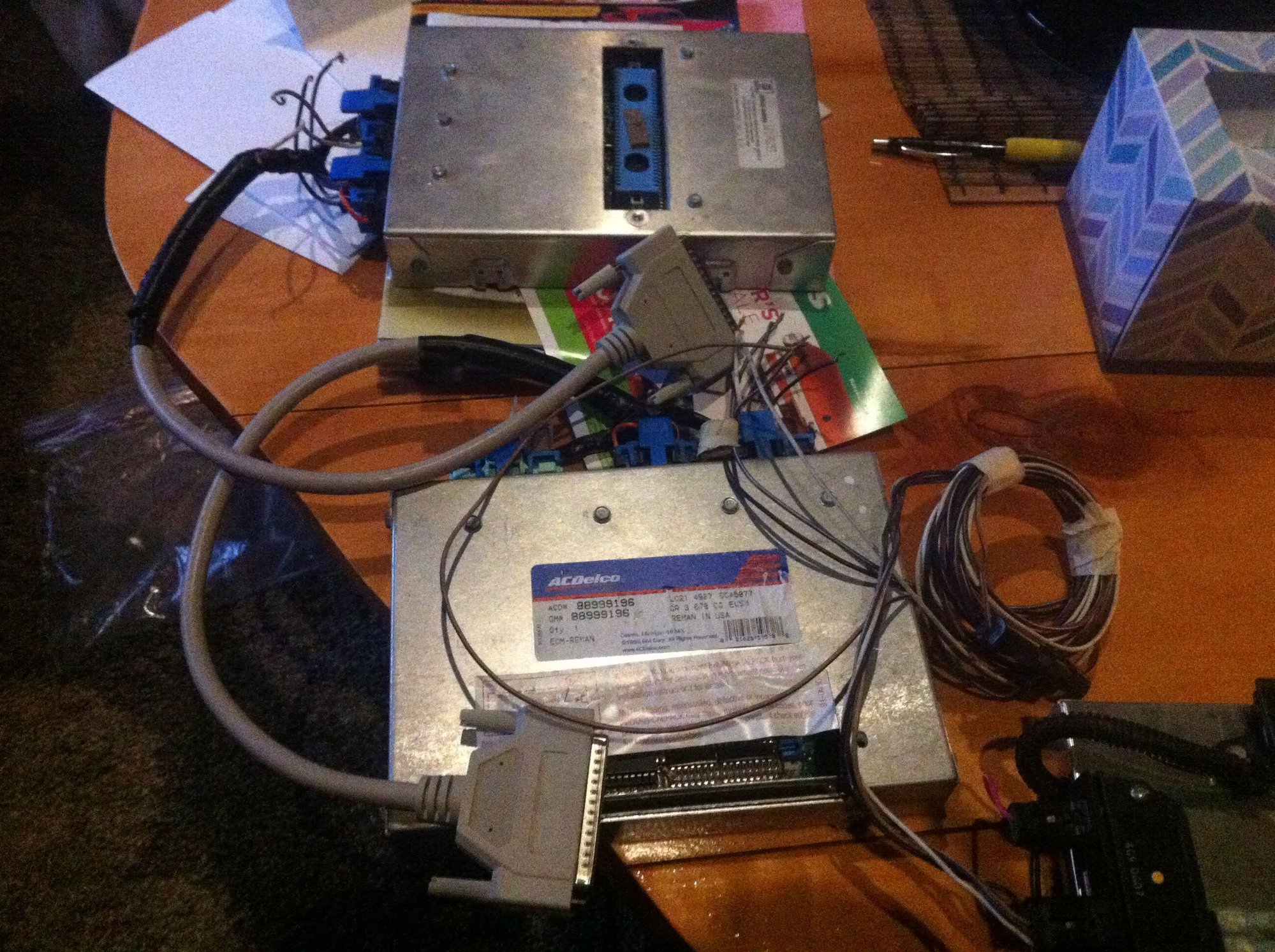

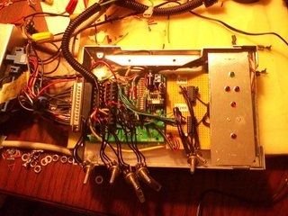

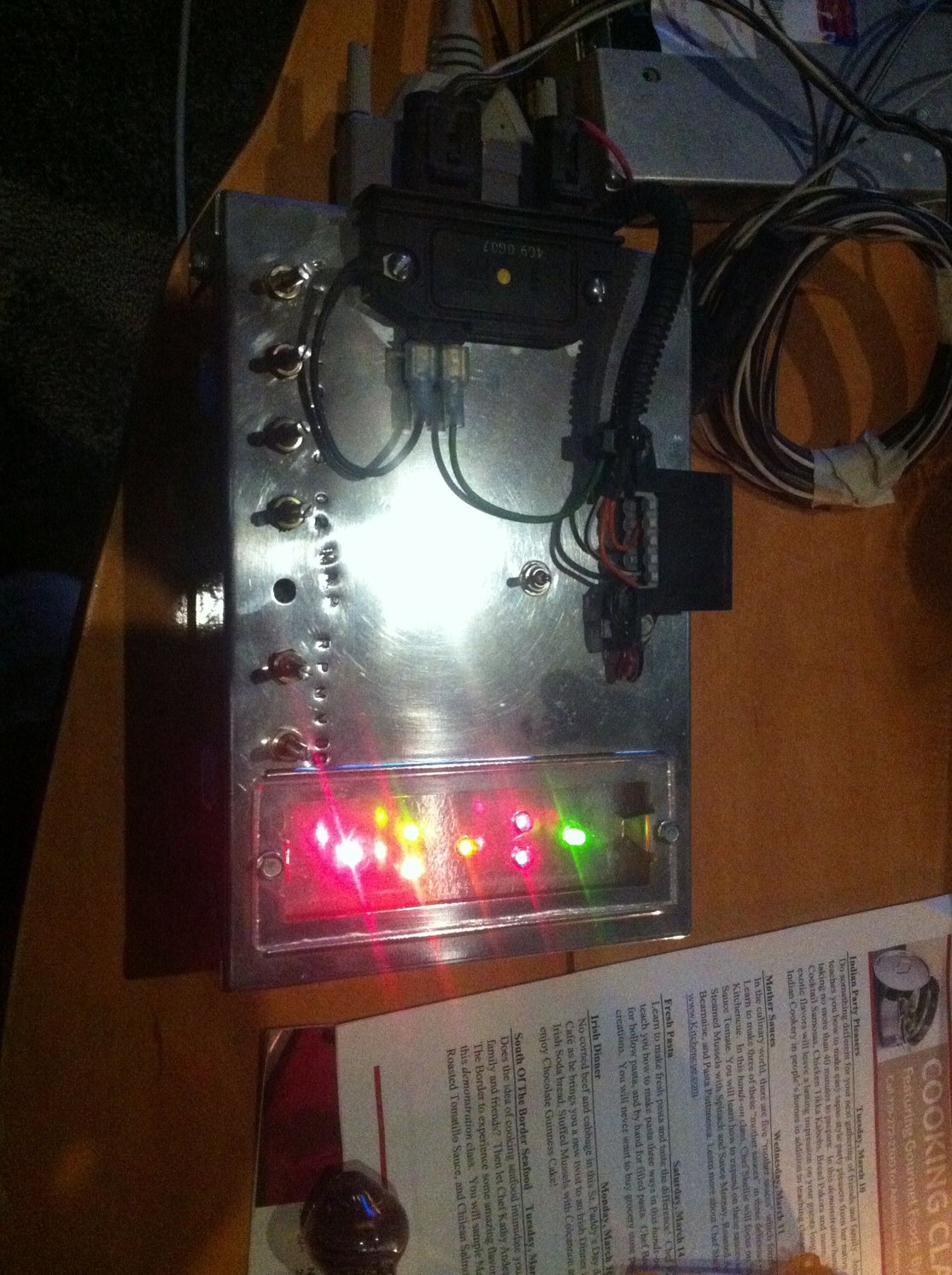

A old thread , But I had someone inquire on the vss rpm generator schematics.
Although not labeled the test bench lights indicate ECM power, injector banks, mil, iac a & b , fuel pump power.
