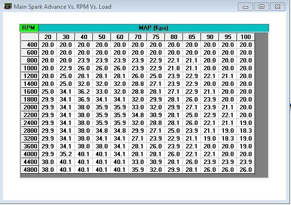

If you have an L98 with a factory PROM in it, and you set your base timing to the factory 6 deg, then timing at any point is what the ECM is programmed to deliver. That's of course if you're not getting any knocking, in which case the ECM will retard the timing to protect the engine.
But If you set your base timing (EST disconnected) to anything over 6, then your total timing at any point is what the ECM is programmed for, plus whatever amount over 6 you put in (unless you re-calibrate the ECM to tell it what your put in).
Here's an L98 timing map. If you put,say, 10 deg base timing, then the ECM will add 10 - 6 = 4 deg to every cell in this map.
