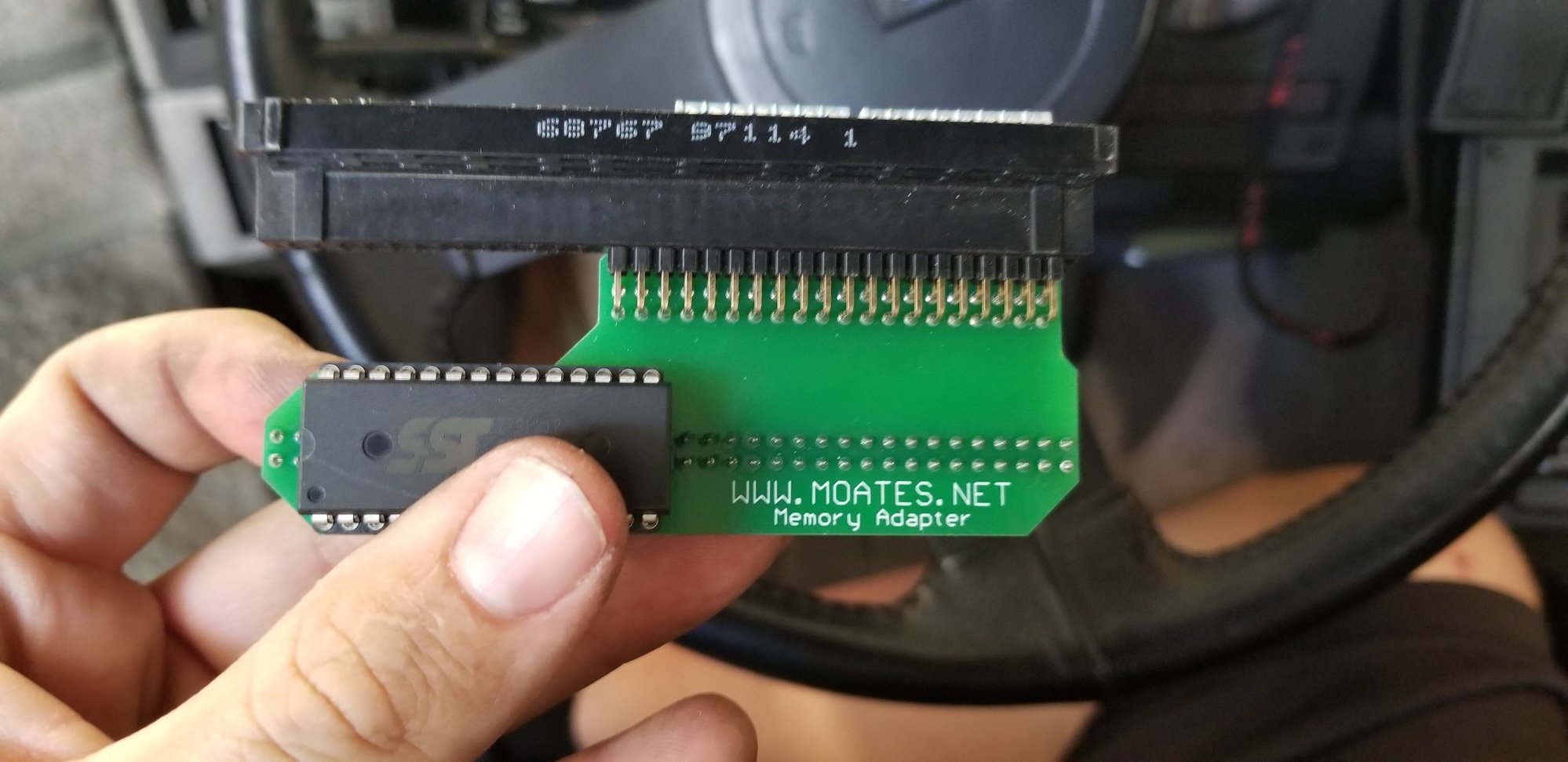

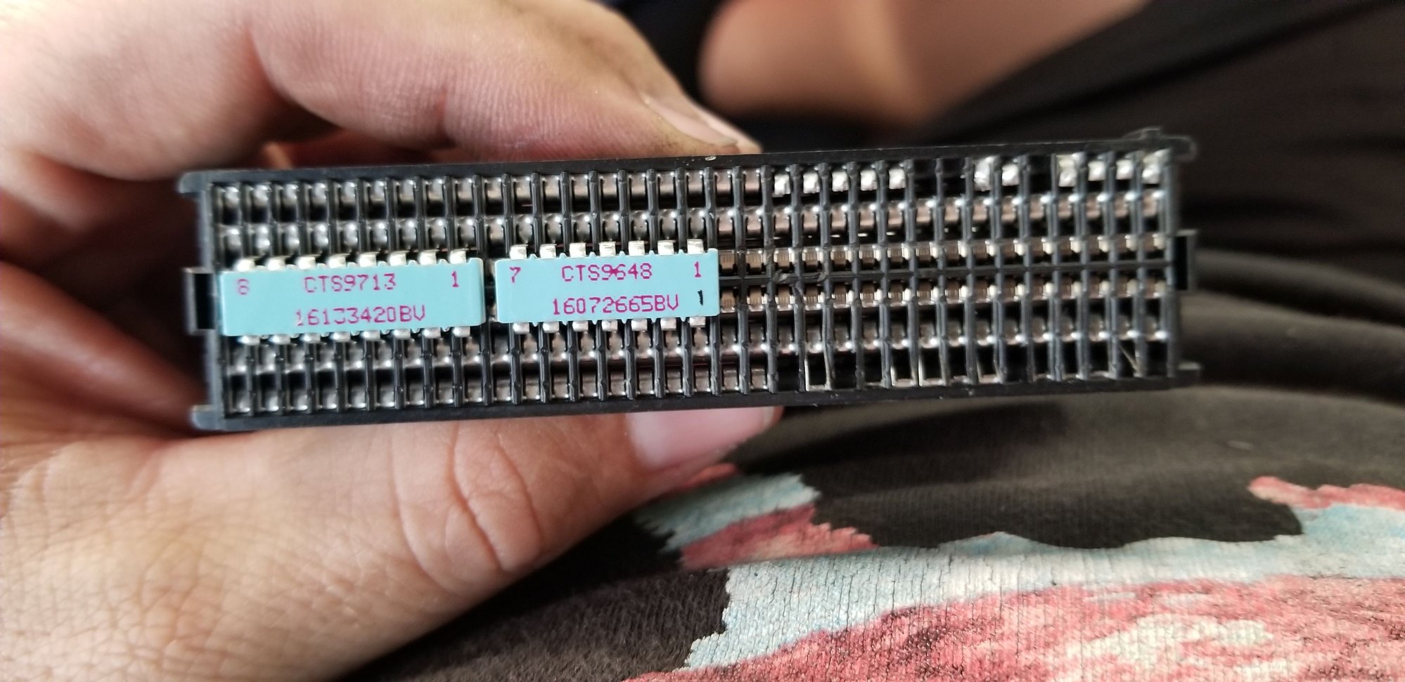

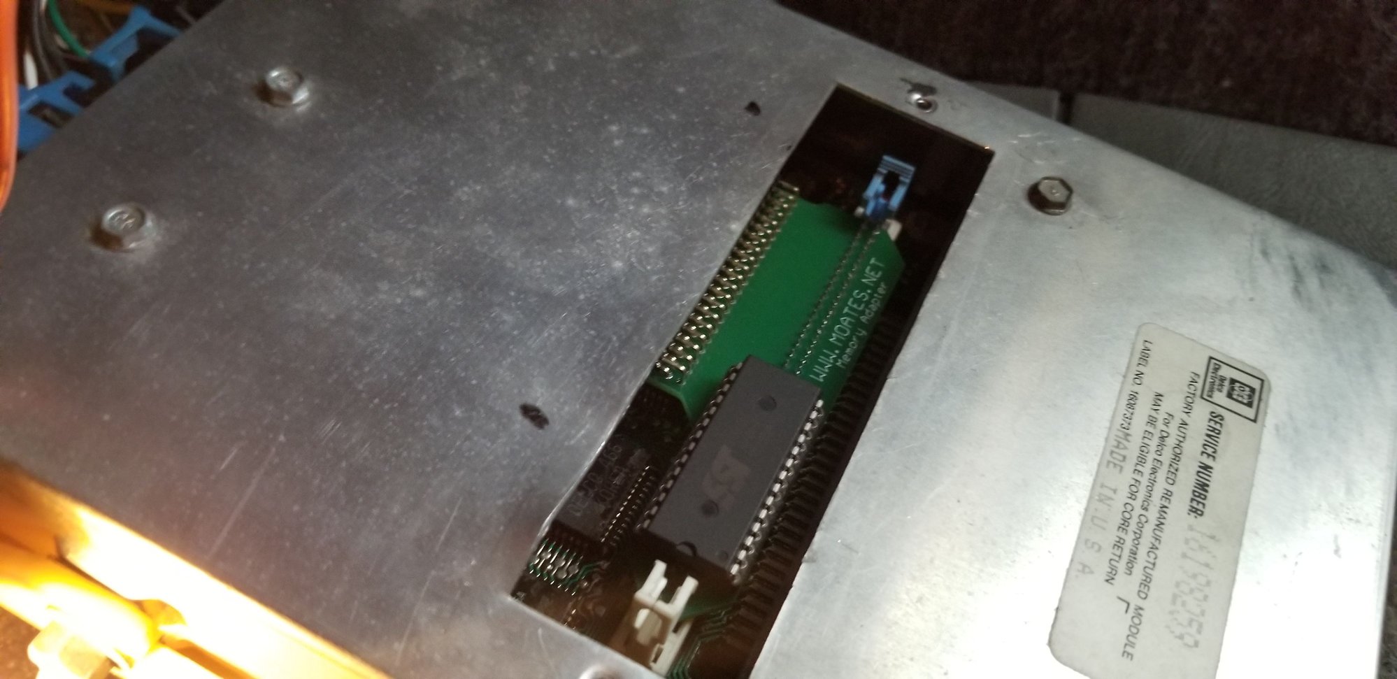

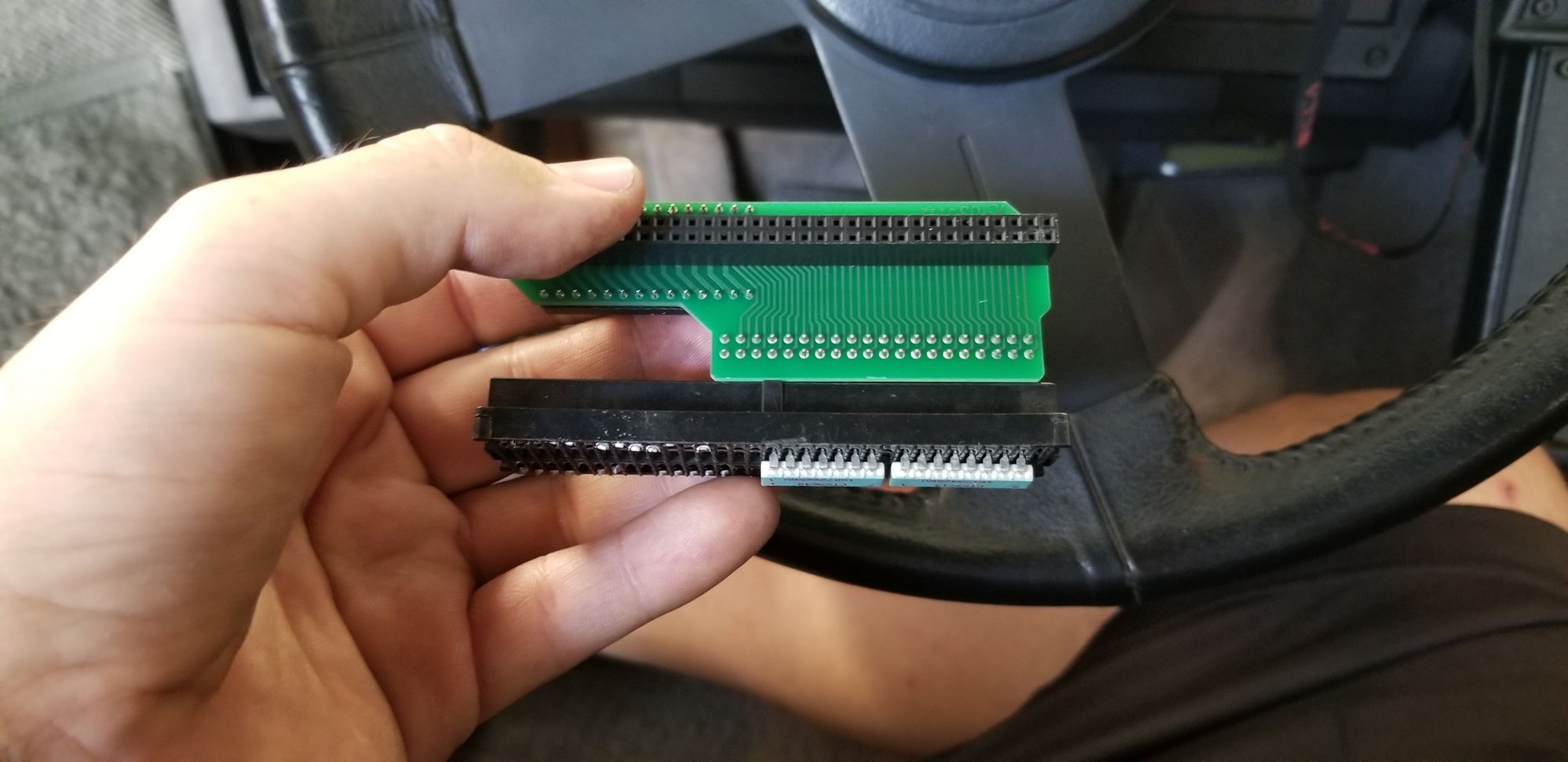

Tell me about this chip please.
Bought an 89 iroc Camaro with a 383. Wasnt running but after replacing the fuel pump its acting crazy. Rpm reading way off and tuner pro showing all kinds of errors in and off. Seems like there is a ecu problem. Pulled the ecu amd this chip looks wierd.

The stock chip has been unsoldered and now is ran off the piggyback adapters chip.

The chip with the tune is still on the g1 adapter. I just think the memcal side has failed.
