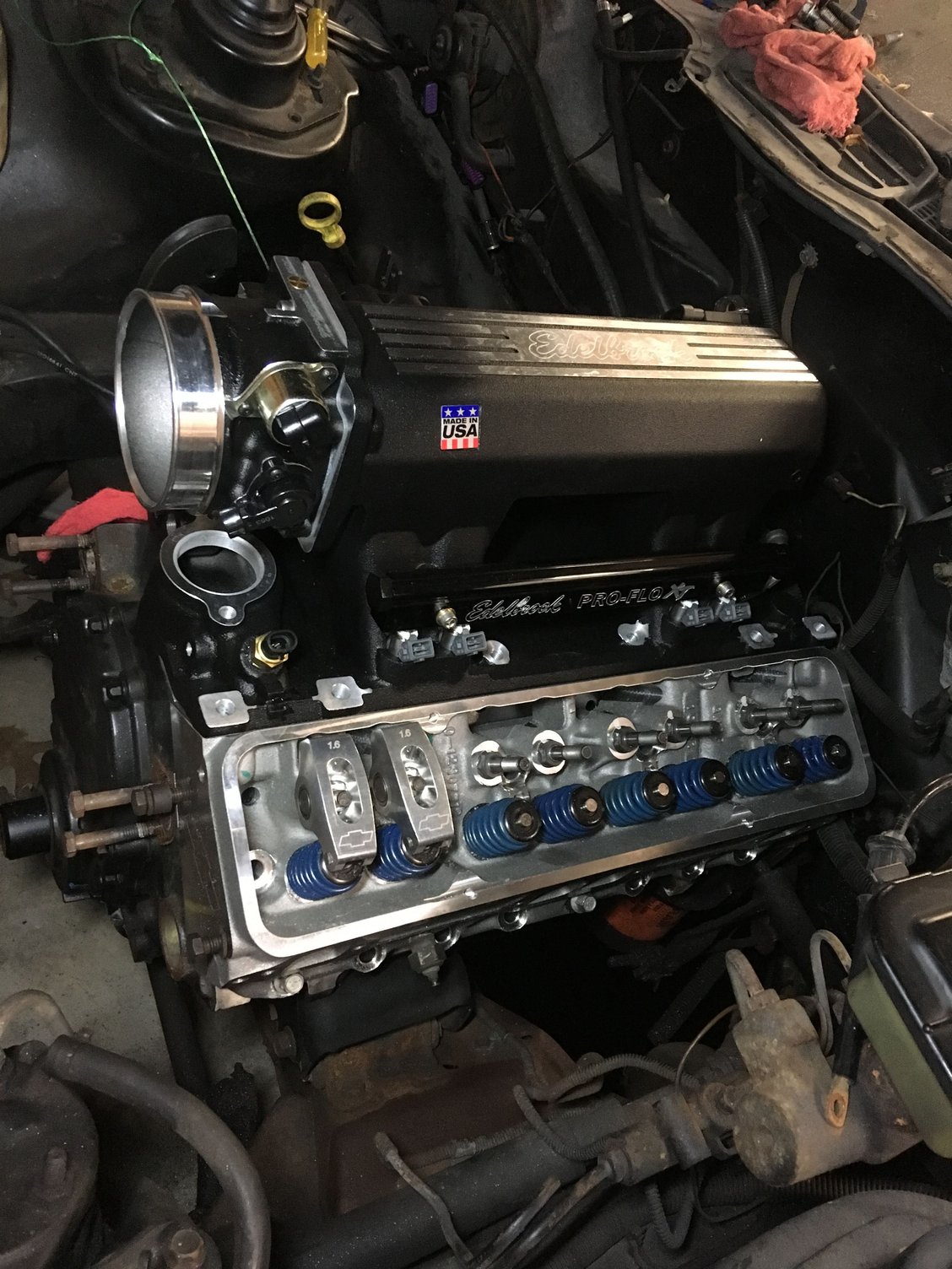

Looking for help picking an ECU for SuperRam 383...
Hello everyone...I was a member here for many years under a different name...around 2000-2010 probably. I have an 89 IROC that I built around that time and it's never run quite right and has now sat for years as I got into different vehicles. I'm now looking to upgrade the computer system in my car to finally dial it in properly. I've read up a bit on the current available systems but would love to hear some opinions based on my actual setup.
Engine is a 383 with AFR 195 heads, SuperRam with Edelbrock base, 30lbs SVO injectors, large CompCam that I don't remember specs on anymore, 58mm throttle body and AFPR, stock distributor. I'm running a 700R4 still and car has mechanical speedo. Car is originally a MAF setup and I think that's part of my tuning issue with the cam. Converting to speed density with one of the newer setups I'm sure will help.
I'm looking for good driveability but don't need to squeeze every last ounce of horsepower out of the car. I know converting to coil on plug is a thing now but is that necessary for my goals? Probably not. What standalone ECM setup will operate my trans lockup, allow my stock gauges to work, and be tuneable enough for a professional tuner to do their thing with?
I'm capable of installing the system myself, repinning any connectors, etc so that is of no major concern. I will however have someone else do the tuning.
If you have a similar combo or educated explanation of a particular system of choice I'd love to hear it. Thanks in advance.

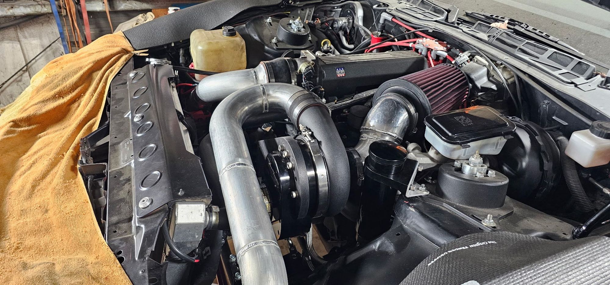

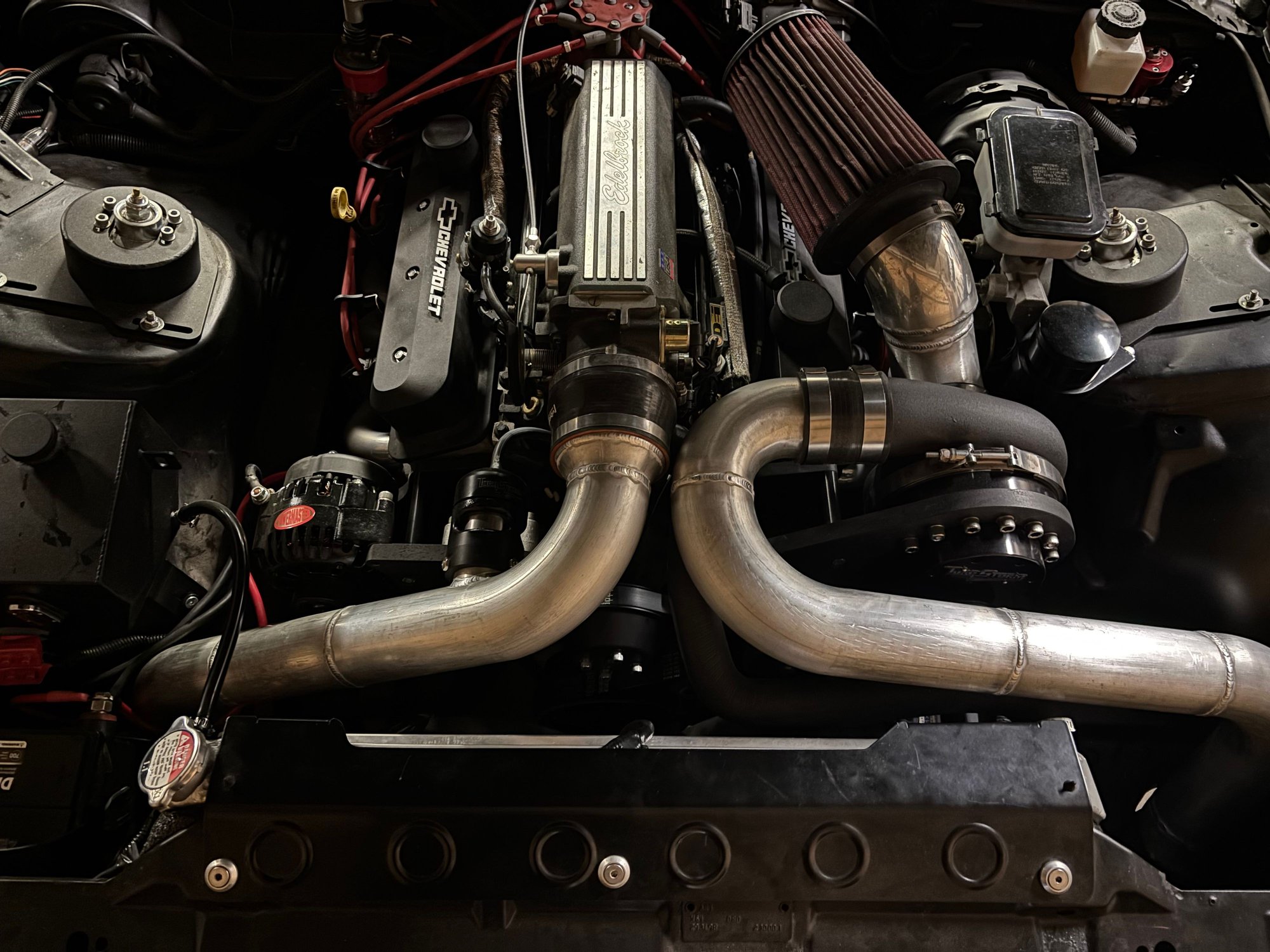

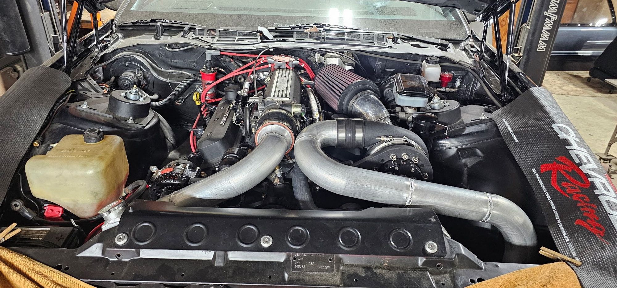

Old Feb 22, 2026 | 08:32 PM
Firechicken82's Avatar
Joined: Aug 2021
Posts: 1,254
Likes: 356
Car: 82 TA
Transmission: Magnum f
Axle/Gears: Ford 9 w 4.11
Re: Looking for help picking an ECU for SuperRam 383...
Heres some pics of the XT. The center hood brace was notched to eliminate any rubbing on the high point of the TB. I feel like that may or may not need to be done depending in engine mounts and trans mounts. The xt has been awesome. It was great prior to the blower and w minimal work/tuning its flawless w the blower.
