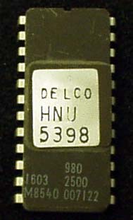

Well... Here's my first wrench in the gears...
Tried reading the stock Delco PROM today... No go. The reader did not even acknowledge it's existance. I had several other PROMs working today in the reader, so the reader is not malfunctioning. I know they can be finicky sometimes...
Any thoughts?

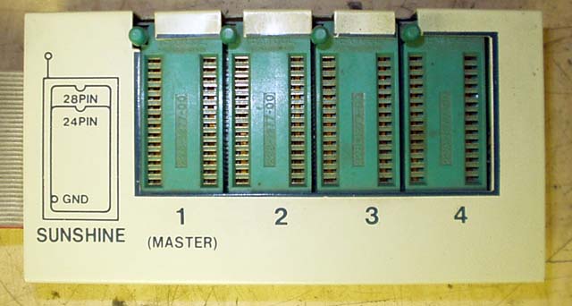

Here's the reader... It's a "Sunshine"!!!

What's the guestion?
HNU is a 86 2.8 5 spd bin.
2732 chip

Hmm... all I can suggest is double check your software installation, your connections, and that you're putting the chip in the ZIF correctly (with the notch facing the correct direction).
I'm running a ROMMAX chip reader/burner, so I'm fairly unfamiliar with this Sunshine thing.

Grumpy: The Q is, why can I not read the Delco PROM.
Pro-Tour: The reader is in 100% functional condition. We use it at work to burn code for our machines. (And, yes, I'm inserting the chip correclty... )
