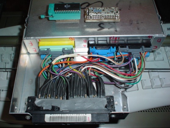

I think that the E pin is 160 baud for both and Mis 8192, but i should be able to get data out of both either way. I also tried to jump pins A and B but the MIL light stays on, does not blink like it's supposed to. I am attaching pictures of the contraption, the comp and memcal are out of a 92 cavalier. If someone sees something that does not make sense let me know.
The issue is not really idle, the car starts and pretty much dies right away, like when it hits the RPM that the ECM takes over. Bad computer maybe, but how are the injector drivers working?
Niko
Niko
You can't use the Cavalier MEMCAL in a V8. The '730 ECM only supports 8192 baud ALDL.
