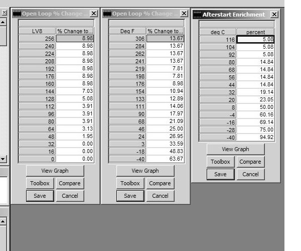

You need to try adding some afterstart enrichment found here:
Edit your .ecu to include:
Start Address 3ED
Rows 14 (columns and element size 1)
Multiplier of .39025
Deg C (Y-axis breakpoints) :
-40, -28, -16, -4, 8, 20, 32, 44, 56, 68, 80, 92, 104, 116
Most engines can run and start on as rich as 10:1 pretty easily, so I'd guess you're a little lean. Add this until it stays running. This fuel will decay out over a few seconds (10-40), and after that, it uses mainly the Open Loop % change vs Coolant temp.
Here's what I use (insert disclaimers here):

I'm using $6E too. You have to edit the .ecu file. It's real easy with Tunerpro RT. The afterstart enrichment is actually in your code already, you just have to edit the .ecu to access it with Tunerpro RT.
First, in Tunerpro RT, open your bin and .ecu.
In the bottom left, in the area with all the names of the tables, right click once. A window will pop up, in which you can select "Insert New ECU Item."
Then type in numbers to match the following attached picture. Then use the pull down for the Y-axis labels to finish entering in the Temperature breakpoints for 11-14, as in my previous post.
I hope this helps. Also, there are many other things that aren't in the normally available .ecu files for $6E that are in $6E. The stuff is in the code in each ECU and the factory calibrated it and all, and it's all editable, you just have to change the viewing software to access it. I used the old $32 BUA hack to find interesting tables, then hunted through $6E to find the same calibrated values (but in different locations). Many parts of $32 and $6E use the same calibration, but they are located in different areas (but things were moved around in large chunks). Good luck. BTW, I'm in China (Nov - Feb), calibrating our new fuel injection computer for an OEM customer, and I need something to do in my spare time, so I'm glad to help.
