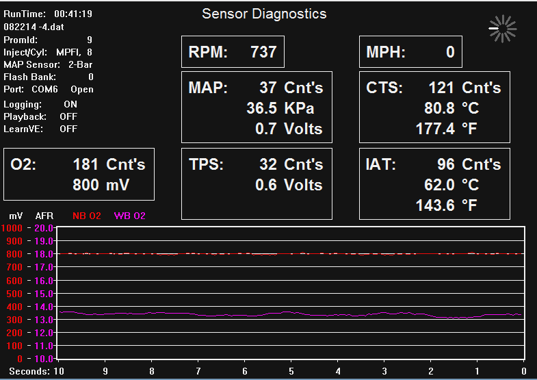

Re: Tuning with the EBL
Earlier today I was doing some idle tuning. I decided I wanted to try tuning the idle in closed loop again. I set the closed loop CTS threshold where it should be and tried checking and unchecking the opidle Flag and for some reason it wouldn't idle in closed loop. CL would enable if I gave it any gas but as soon as It dropped back to idle it went to open loop again. Any suggestions on what could be causing this? I'm running a 3 wire heated NB to btw..

Okay finally back to some tuning; thanks to Rbob. So I have the same 350 tpi auto that i now have a new FPR in place and replaced the fuel injectors with siemens deka 60lb injectors - I did adjust the battery voltage table (I attached the spreadsheet I used if anyone else wants to use it)
Anyhow, clearly the injectors were crap as the car now runs a ton better but I am confused by some of the things i am seeing. FYI, I could not find my fuel pressure gauge and I am intentionally trying to set the fuel pressure as low as possible to keep the flow from the aeromotive pump in its sweet spot. Though I suspect my FPR has the fuel pressure slightly higher than where it was because I had to put the screw lower as I found it was about to fall out as set on my last FPR. At my previous FP the 60lb injectors would act as 61lbs so that is what I entered into the EBL.
Interestingly the car was running lean with the last good tune, so today I did a bunch of WB VE learns increasing the VE and at about 3000 RPM in 1st gear the WB is still reading about 15.5:1 or so with the VE table in those cells at 100% and with a 7% DC???? (I posted a WUD Snap shot during the VE learn prior to increasing to 100% VE) I suspect it has something to do with the fuel injector pressure and how much fuel the computer thinks it is giving but I certainly should not be able to max out my VE and be lean with 60lb injectors and no turbo. So now what?
My second Q: Think I answered this: They more or less agree, the car wouldn't go CL with the hood up but with the hood down it reached temp and I was reading the graph wrong. over ~450 is rich and less is lean so wb and NB both say rich. Did a NB tune after and it seems to want to pull more fuel out than the WB last time this gave me some lean surg so I will play it out some but I might just need a heated O2
Okay I also noticed the huge difference in WB vs NB voltage; I changed the NB O2 sensor with my tear down of the TPI... I searched posts and found that plenty of people had no problems with a particular Bosch sensor and the Edelbrock TES headers I have. I also know I have a small exhaust leak in the passenger header which is where the WB sensor is; whereas the NB is in the drivers side. I suspect I need a heated NB O2 sensor... what do you guys think? I believe the WB as I was getting lean surge and as it brought the AFR down the car ran better.

Change the 0 volt entry of the offset table to the same value that is at 12.8 volts. This is done to cover the case of a missing voltage reading to the ECM.
As for the VE% hitting 100, go back to the BIN before you did any VE Learns. Then adjust the fuel injector flow rate in the BIN until the BLMs fall into place. They won't be perfect, just need them in the ball park.
Then do VE Learns to round it out.
RBob.
RBob.
