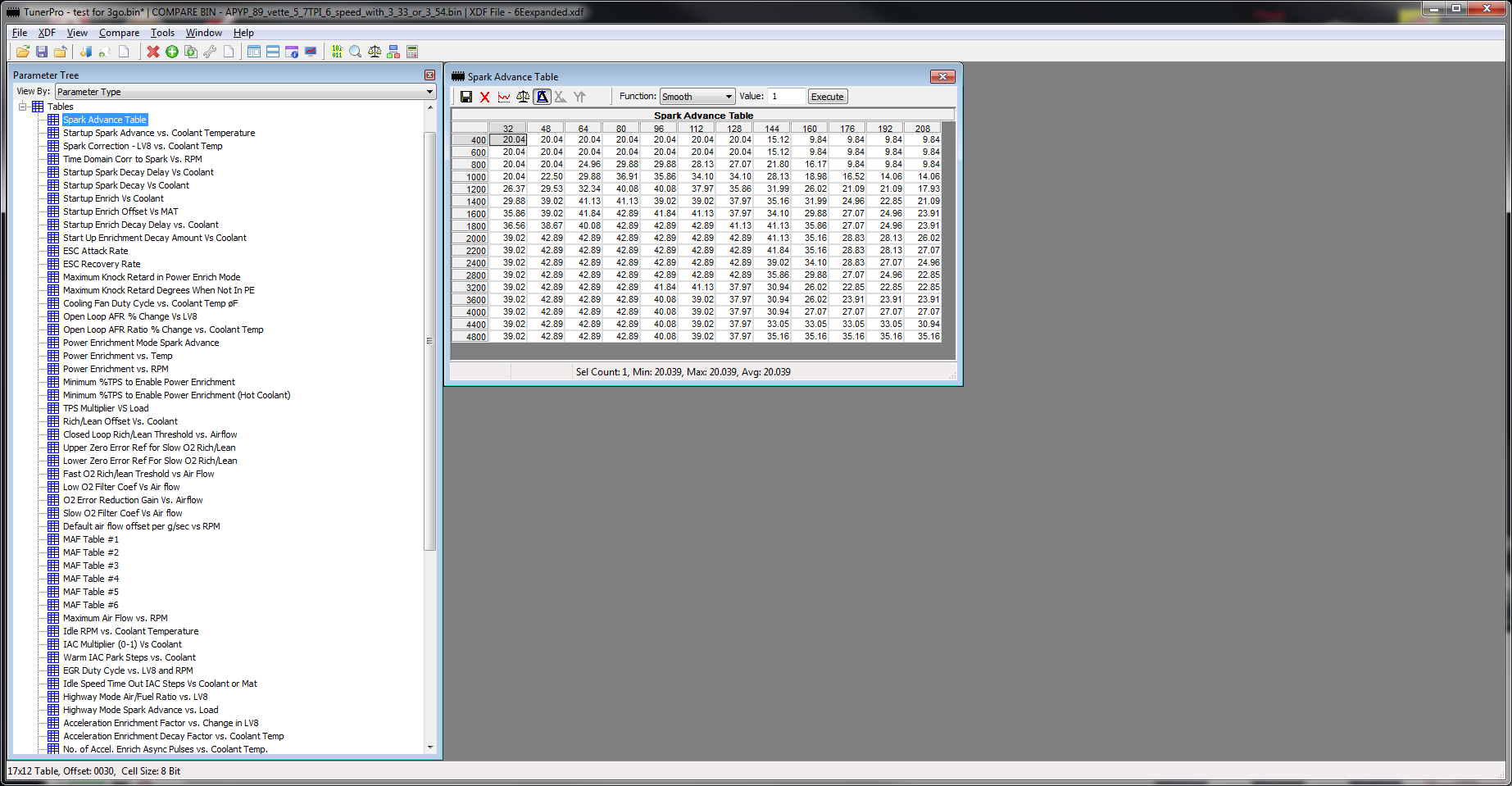

I recently posted this as a crash problem. I think I figured out that TunerPro simply would not copy because some cells in the table are locked. I have been able to copy most cells from one spark table into a different spark table but when try to copy some cells they turn red and refuse to copy. This leaves a big difference in tables.

Thanks Scorp, I did know that but the problem is they do not update. When I hit save the chart closes as normal when I reopen ithe chart, it has same old number in the cell. Seems like the middle of the chart will not update for some reason. I'm stumped!

I know. Here's the screen shots. more in next post.
Attached Thumbnails tunerpro copy chart problems-spark-1.jpg   tunerpro copy chart problems-spark-2.jpg   tunerpro copy chart problems-spark-3.jpg
Old May 16, 2012 | 02:53 PM
utilityguy2's Avatar
Joined: Mar 2010
Posts: 486
Re: tunerpro copy chart problems
spark 1 is table i want to change
spark 2 is table i want to copy from
spark 3 shows the updated cells
spark 4 shows the resulting table
spark 5 shows the differences
help is appreciated

In other words, the cells in the lower center would not update. Puzzled!
It appears to be an upper limit error. Check the XDF entry for the SA table and see if there is an upper limit to what can be entered into a cell. Likely set to 43*.
RBob.
yes it is 43 but both chart xdf entries are 43 and one chart as you see goes beyond 43. But I will test and report back.
Old May 16, 2012 | 03:32 PM
Joined: Mar 2010
Posts: 486
That was it!
Thanks RBob, I knew you would know. Thanks also Scorp1us for your response.
I believe this was my problem with Tunerpro crashing while trying to copy a chart also. I had tried to paste previously and when it wouldn't update, I tried again which causes Tunerpro to crash.
I wonder why the upper limit was lower than the chart entries and how it could have worked that way. This is a stock bin so has always been that way. must be that Tuner Pro puts the limits on as a default 43. Maybe RBob knows but I sure don't.
