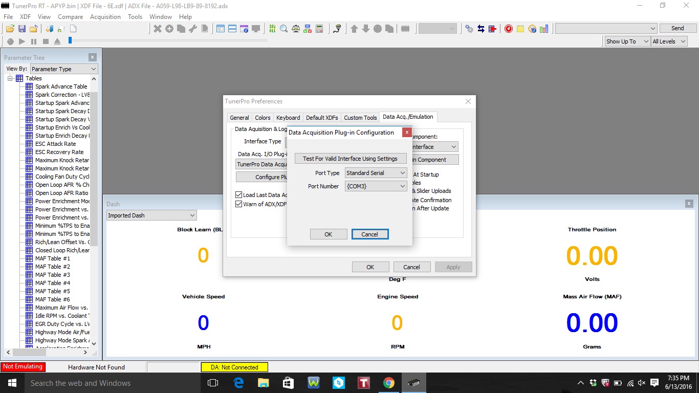

I had a similar problem. I found that Tunerpro will not detect the com port you have the ALDL cable connected to, you have to tell it which one you want to use.

Ah, I failed to mention that. I had the computer recognize the cable in COM3 on my labtop, and set tuner pros settings to COM3.

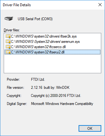

You have to go to device manager and set the com port number for the cable (you will see it change and add an item when you plug the cable in. Right click on that new item drill down to the port setting & change to the com # you want to use)

Maybe these will help. I feel as though I have everything set up correctly.
