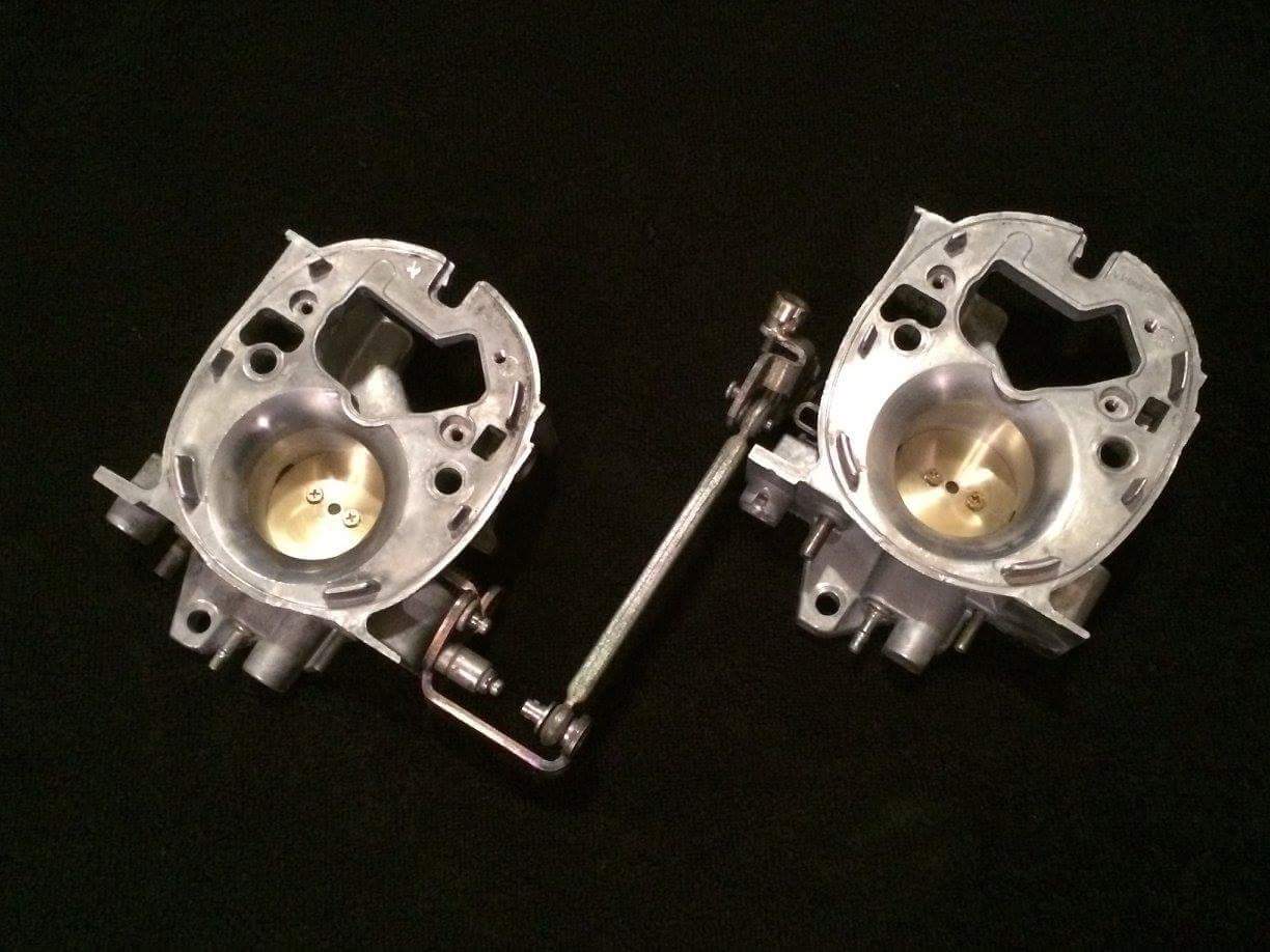

Bored out TBs on renegade intake.
If you look carefully, you can see the GM marine pressure regulator modded into usage as a VAFPR.

Re: Suggestion on SA table for AFR 916 Heads
Bored TBs...
Max Bore did the work and added bushings to the shafts as well.

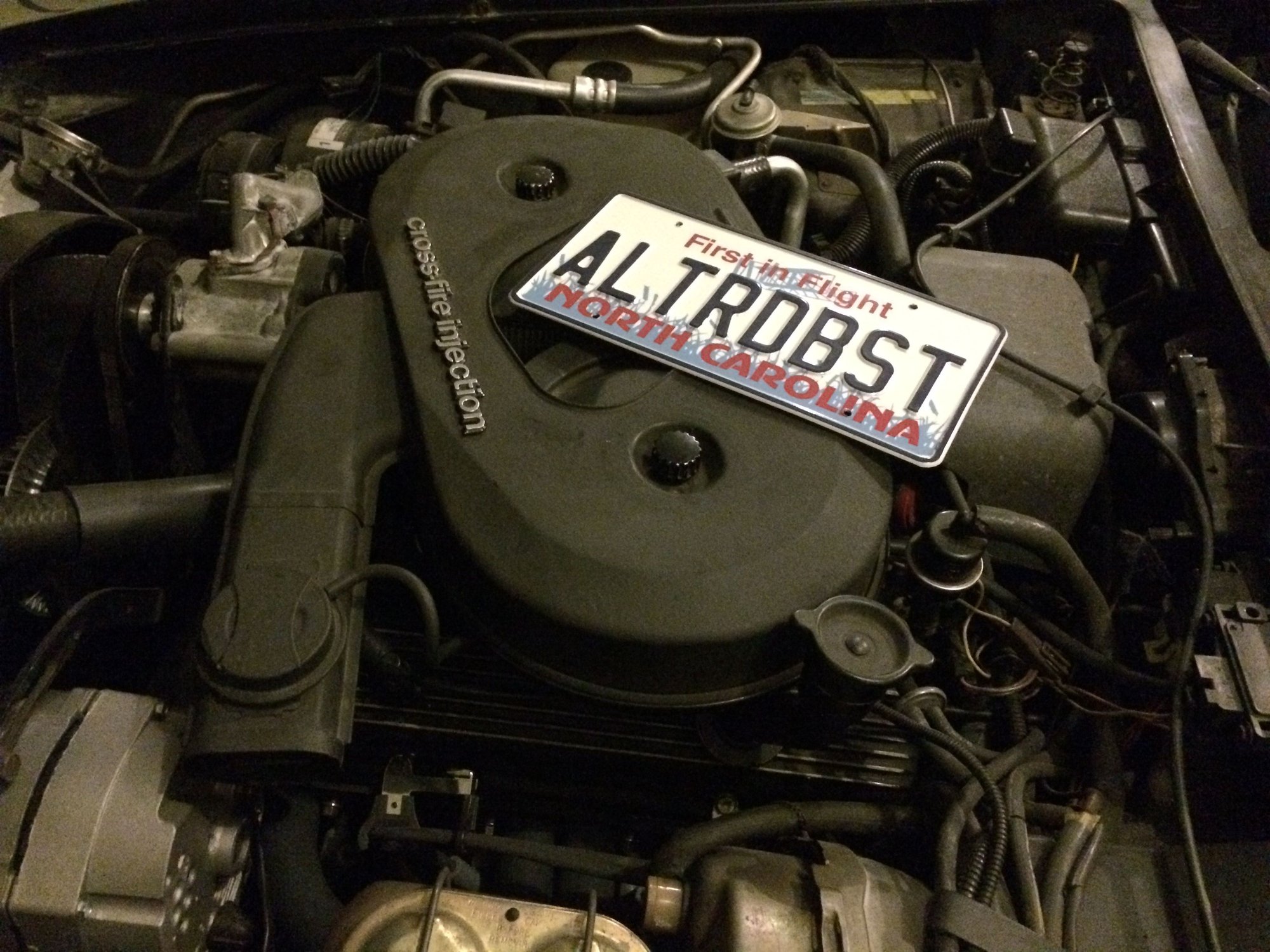

Posts: 167
Everything hides under the OEM air cleaner. The snorkel is blocked off and it breathes through the fresh air chamber ducting in the hood. It gets plenty of air that way and the air charge stays fairly cool & dense during WOT.
If you look closely, you can see the headers on cyl's. 3 & 5.
Looks like factory- doesn't sound anywhere near close.
