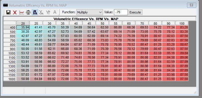

after changing the bin and modifying it to work with my injectors, it will go into closed loop now. Now that you say that about the o2 sensor though, will this cause it to read lean, or does the heated o2 sensor only help it to reach closed loop sooner?

I data logged today and going down the highway i noticed the oxygen sensor is bouncing from 8-900, the lean to rich status is doing the same. This is probably the surge ive been experiencing at highway speeds. Im not sure if it needs the heated sensor or just the new sensor all together! When i get the sensor in I will datalog again to see if the issue went away.
Thanks for the help

Blm averages 140-160 I’d try to work on recurving ve. Was voltage offsets and lower pw tuned ?

I am running the bosche III injectors. I added about 15% to the existing VE table and removed about 25% from the voltage offset. i haven't touched the Pulse width yet. What would your recommend. I'm very new to this. I just want my car to run smooth and reliably. I am also running a miniram intake i bought from you lol! I noticed if i advance timing to about 10 degrees BTC the car accelarates a bit smoother especially around the 1800-2200 rpm area. I think i should add a bit more timing in that area but im not sure how to change that map. It idles better when at the 6 degrees but stumbles around 1800-2200. I am waiting to see what the 02 sensor might change for me as i did notice the 02 changing a lot there too.

Some comments:
  1. If engine is running with bin posted in #8 above, it's a miracle. All values are 0xFF. Please post bin that provided csv log in post #22. Also post your xdf file.
  2. o2 sensor appears ok at idle and otherwise. Only had one OL period during idle at samples 1022-1051. Cross counts are being registered which indicates it's operating correctly.
  3. BLM for the most part is pegged at 160 Lean or 108 rich. INT also lean in the 140s at idle but seems normal when running. Makes no sense.
  4. Some PW values while not idling should be flooding a 5.0L engine. They don't seem to be what they should be.
  5. Voltage at just over 13 seems low at both ignition switch and pump. Not related to how it runs, but just seems low.
  6. IAC steps seems very low at idle (5-10) and TPS voltage too high (0.75). Have you adjusted the IAC and TPS according to factory procedures? Seems that is needed.
  7. Forget messing with voltage offsets. They merely add fuel which does not seem to be needed.
  8. With those injectors, recommend zeroing out the low PW table.
Having said that the o2 sensor "appears" OK above, changing it would seem warranted because in CL it's what determines the INT and BLM which are clearly not right, and BLM helps determines the PW.

Im not sure how the car ran with that earlier bin either. Here is the bin and xdf i used to create the log. the csv file seems to have filtered out a ton of stuff the actual datalog showed.
The car is a 92 speed density system so the TPS is non adjustable. i have re set the IAC many times i may be using an incorrect method though. "turn key to on, wait 30 seconds, unplug IAC, turn key to off plug in IAC" I may have to search the forums to find a better way.
I have set the low PW to zero and changed the voltage offsets to ones that tunedperformance steered me towards. The tune attached has neither of these done. I installed the tune late last night and the car idled fine and pulled into the garage with no issues. I still havent installed the new O2 sensor yet as today has been a busy day with the family.

Thanks for the correct BIN.
1)
Some TPS sensors (even for '92) may require slightly rounding out of the mounting holes to achieve the required voltage. The voltage cannot be higher than 0.78 volts at 0% TPS or the ECM will think the engine is not idling.
2)
Procedure for setting IAC is a bit more detailed than you described. Maybe you provided just a summary but see attached doc.
3)
With all respect to tunedperformance, all the voltage offsets do is add fuel. Unless you have a finely tuned race car, they are not your issue. You could use virtually any values because whatever the values are, they are added to the PW computed from your VE values. To begin, just keep offsets at some value and adjust VE to get proper BLM/AFR. See Post #1 here: https://www.thirdgen.org/forums/diy-...ml#post6322496
