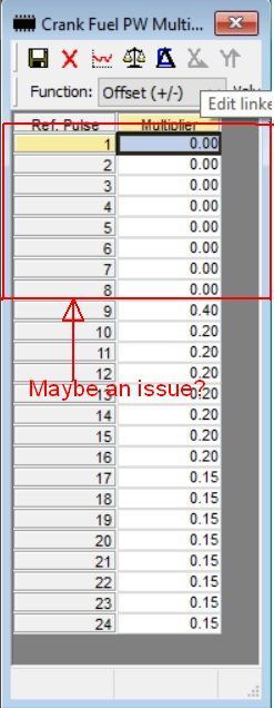

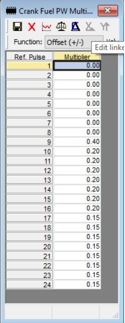

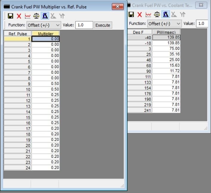

Here are some tables regarding coolant temp. These startup tables look strange to me. Are they in play during cranking?

I'm not nearly as good as some of the people here. But I don't see anything out of the ordinary with your tables. People have had long crank issues having the crank fuel PW multiplier zeroed at the top. I have 1's from my 1-8 values. My car starts with 1-2 cranks hot and cold.

Looking at your table, "Crank Fuel PW vs Coolant" does not look right. What conversion is being used by your XDF? If you could post the X values without conversion that would help.
You were saying pedal to the floor was fixing the problem, so it points to too much fuel. But now you are talking about "long crank" in post #8. A long crank which fires-up without pedal to floor indicates not enough fuel or not enough starter power to turn engine over 300rpm.
Usually, tuners will add value to DRP 1-8 to help with long crank. By doing so, it will add more fuel. See post #10 @RBob
The 2 tables "Start-up bla bla.." you posted are not involved during cranking

When cold it start instantly. I always found that a bit strange since the table avove indicates no fuel for the first 8 ref pulses. But if that is a very short time it migt be correct after all

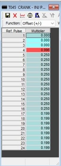

I updated post #5 and 7 based on @RBob clarifications. He is always a great source of knowledge.
For table "Crank Fuel PW vs. Coolant Temp", I believe the right formula is 0.200004878 * X + 0.000000. Nonetheless, if you enter "X" in conversion instead of "0.781300 * X + 0.000000", you will get a non converted value. For APYM, I get:
-40_179.00
-18_179.00
3_77.00
25_41.00
46_34.00
68_21.00
90_17.00
111_14.00
133_14.00
154_14.00
176_14.00
198_14.00
219_14.00
241_14.00
You seem to have:
-40_179.00
-18_179.00
3_77.00
25_41.00
46_34.00
68_15.00
90_10.00
111_6.00
133_6.00
154_6.00
176_4.00
198_4.00
219_4.00
241_4.00
Also,
APYM has:
So it looks like what ever modified version of APYM you have, it has reduced cranking fuel delivery.
My advise: If you have all original set-up, with OEM fuel pressure and injectors style, I would bring APYM back to original settings to start with.

154_14.00
176_14.00
198_14.00
219_14.00
241_14.00
You seem to have:
-40_179.00
-18_179.00
3_77.00
25_41.00
46_34.00
68_15.00
90_10.00
111_6.00
133_6.00
154_6.00
176_4.00
198_4.00
219_4.00
241_4.00
Also,
APYM has:
I've had issues with weak battery which resulted in long cranking. I can't explain it other than it appeared while cranking the voltage was getting in low 9s high 8s volts. Engine rpm was flat at 200 rpm. Engine would not fire-up for 6 seconds of cranking. Once engine would reach mid 200 rpm with high 9s voltage, it would fire-up. Issue was present only when car had been sitting for a few days. Changed the battery and problem went away. Installed a on board battery charger. Car is now plugged whenever it sits. Never had the issue after. My only conclusion is, low voltage affected injectors or engine rpm was too low while cranking. But I can not verify that with certitude.
I have attached an OEM version of APYM
Hope this helps
Ok. I will go back to the original APYM bin. But that this mean that there is an errror in my xdf file? How do I get an updated $6E XDF file? Or should I edit my XDF file? Sounds scary…
But the correct value seems quite a bit lower than in my file
