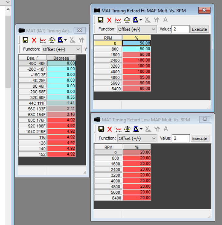

Decided to add a bit more depth to the MAT timing adjustment. MAT, MAP, RPM, flexfuel based adjustment now.
Now the ECU pulls the standard MAT adjustment, checks MAP and decides which table to pull from (adjustable but set at 65kpa = high table). Then it pulls another table that multiplies the timing adjustment by RPM. It also takes into account the flex fuel blend ratio and subtracts from the multiplier.
Calc: Spark timing advance = Timing - (MAT adjustment * (MAT RPM % Multiplier - (FlexBlendRatio * 8)))
So if Advance is 30 degrees, MAT adjustment = 5 degrees, Flex Blend ratio is 10 (full e85), and RPM multiplier is 100% @ 3600 and MAP is HI then: New advance = 30 - (5* (1.00 - (10*8))) = 29 degrees.
But if flexblend is 2 timing = 26 degrees.
If advance is 30 degrees, MAT adjustment = 5 degrees, FlexBlend is 0, RPM is 20% @ MAP 30kpa then: New Advance = 30 - (5*(0.20 - (0*8))) = 29 degrees.
I have the code 99%, but forgot to add in a safety stop to the flex fuel subtraction so it can't go negative.
Testing NOW
Once finalized and checked I'll implement this into the Flex Fuel bin.

Added a Scalar to adjust the MAP value.
Added more resolution to the RPM tables.
Been running this today. Nice to have timing more optimized for conditions. Now I can tune off weather and heatsoak instead of dealing with seasonal changes.

Just took a drive at the hottest part of the day and didn’t see my typical kr blips AT ALL. first time in years.
this code is amazing.
Added to FlexFuel Bin
