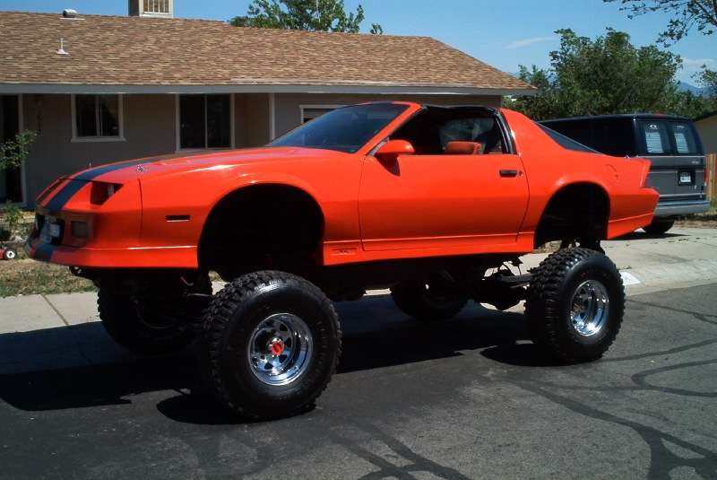

so what youre saying is a master mechanic beats sh*t with a hammer to make it work? lol, i didnt mean to offend you sayin that about the hammer bro, chill and lower ur bs flags. i didnt stick my head under my car when i tightened my connection, i looked under there and could reach it w/ the wrench, still the first thing you should do is check the ...ehh nevermind i said it before.
as you can see i can climb all around underneath my car lol

jk, my car is better suited for handling than muddin'

I lowered my flags. I'm sorry- but I really wasen't in the mood. I just replaced the starter and guess what nothin!
Hey- nice lift on the camaro LOL
