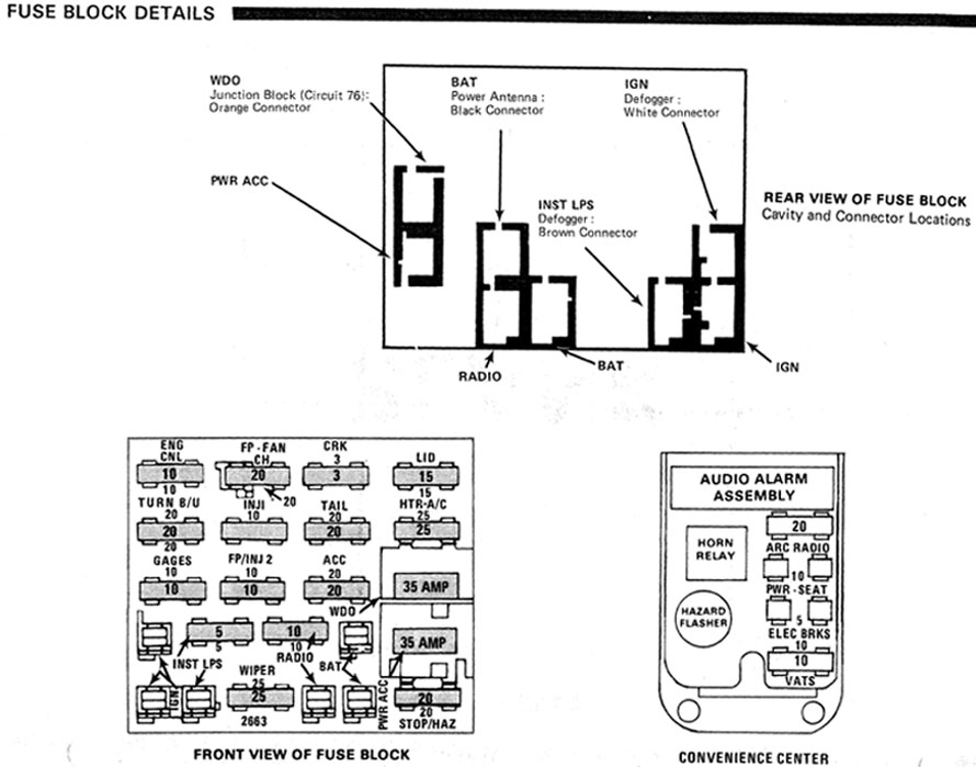

Have you checked the PWR ACC fuse? It is one of the 35 AMP metal fuses and it supplies power to the ignition switch as well as several items that branch off from the ignition switch.

i checked the PWR ACC fuse and its good but its not getting any power.
