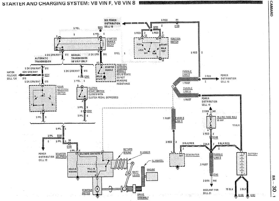

just went back and cleaned terminals to make sure they were good and hooked them back up, and decided to check voltage at starter with key turned, not just with test light. I don't know if I tested it wrong before but there is power there all the time, even when the key is out. Should there always be power to the solenoid on the starter? Secondly the red wire at the ignition switch, where is it? I know where the ignition switch is but where do i find red wire to test.
Old Apr 16, 2004 | 08:42 PM
Trickster's Avatar
Posts: 6,127
Likes: 12
From: conway, s.c.
Car: 1989 Iroc-Z
Engine: 5.7L TPI
This schematic should help with that. The red wire comes off pin "A4" at the firewall connector on the drivers side and has a second wire spliced into it. One goes to pin "C1"(B3) of the igniton switch and the other one goes to pin "C2" (B2)of the ignition switch. The yellow wire which goes to the starter enable wire comes of pin "C2" (S) of the ignition switch. The letters in parenthesis are the markings on the switch. Hope this helps some.

PROBLEM SOLVED!!!!!!!
Thanks for the diagrams and help Trickster. I checked the park indicator wires today and found out that it was disconnected. While I was screwing around with the BOSE crap the large interface pushed on the park harness. It must have been loose for a while because it happened once before and then was fine. That is why I thought it was starter finally going. I got a new starter (first time install) and starter enable relay (security relay is what dealership calls it) out of it, but it was still cheaper than a tow and I won't worry about starter anymore. Also did a tune up with plugs, wire, and cap, coolant bypass, and 180 degree thermostat ($5 on clearance at SLP). Car runs perfect now!
Thanks again!
