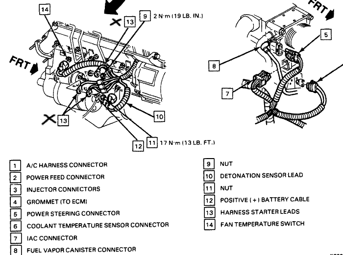

It would be the items in this picture with the number 13 (X marks the spot). They have large terminal lugs and go on the large post on the starter solenoid with the battery cable. The purple wire with the small terminal lug goes on the small post marked "S" on the solenoid.

a guy with a 89 rs was just telling me how his nut on the big leads on the starter was a lil loose and then he got no power wut so ever to his car. similar to wut u sent. thanks a lot trickster . x marks the spot LOL
