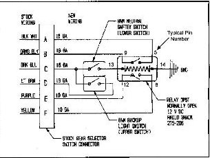

here is how I hooked it up last time.....FWIW.
Attached Thumbnails Problem after swap!-b-m-shifter-instructions

I wired the fat purple and fat green wire together..that was all I needed to do to make the starter work..soooo, thats where I left it.
