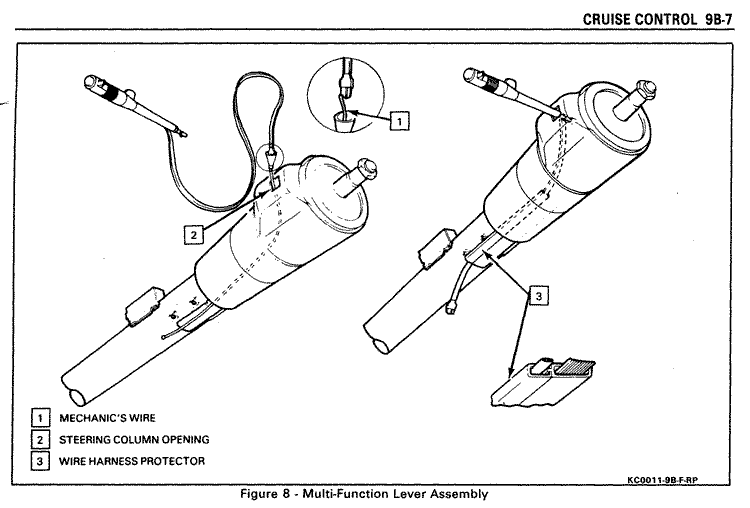

There is a switch on the brake pedal and a cruise control module mounted behind the dash on the passenger side. BTW, there is also a wire harness that comes down the steering coulmn from the multifunction lever that is for the cruise control and there is also a wire bundle under the dash that goes through the bulkhead for the cruise control. Here is a picture of the multifunction lever harness and the one that goes through the bulkhead.

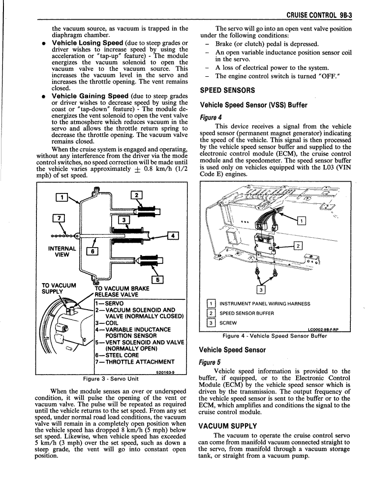

page 2

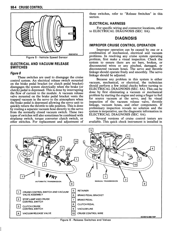

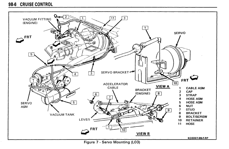

If you think that you might have a vaccum problem then you might want to look at these pictures. Also that electrical device with the hard vaccum tubing might be your EGR solenoid. I can't tell without seeing it.:lala: BTW, in this picture where you see #2 is a cap, that is supposed to be the vaccum line that goes to the HVAC control unit in the dash.

page 2

page3 :lala:
