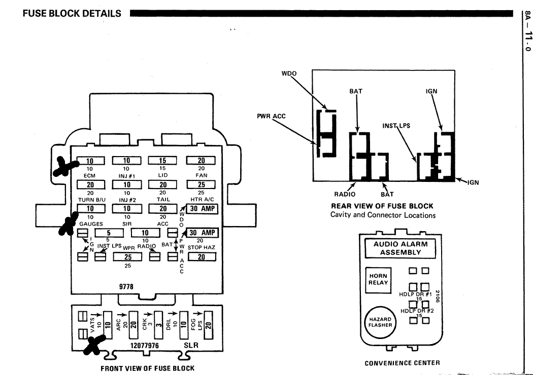

Okay, on your car the VATS fuse is on the fuse panel and not in the convenience. Here is a picture of your fuse panel with the fuses marked. You mention that the tumbler is brand new, are you using the key with the pellet in it or are you using the brass key that came with the lock cylinder?

You straightened me out on that one about two months ago. I am using the $30 key with the chip in it. What book are you pulling these wire diagrams from? The one I have basically sux. You can't read half the stuff and it doesn't show which wire really goes where. Thanks for the help I will go out right now and see what I got. Thanks!

Okay, car cranks wants to start but.....back fires through the TBI. I know this how? Because I no longer have eyebrows or hair on my right arm. Seriously, she is spitting a big fireball out. Not sure why because I didn't mess with any timing or anything. My fuel pump is working the motor is cranking and my homemade resistor is in place. Think maybe I need to play with some timing? Any more ideas? Thanks!

Did you by any chance have any of the sparkplug wires off? Just a thought, a friend got his wires on backwards and got some nice fireballs from his throttle body. Said he had been half asleep at the time and that he was wide awake after it happened. Not to mention that he also had to go change his pants. You may also have accumulated a lot of fuel in there when you were trying to start it earlier. How do your sparkplugs look?

I didn't take any of the wires off. Didn't play with anything under the hood except to check the fuel pump/fan relays. I think I just got to much fuel in there considering when I finally got my fuel pump working I was playing with it for about 10 minutes. All the while grinning like a boy who just found his "magic toy".
I'm gonna give it a rest for a little while, charge the battery back up and let some fuel evaporate. I'll try it after I BBQ me some burgers. Thanks!

Alrighty then, here is my current status. The car will start IF you continue to hold the key forward (in the start position), but as soon as you let go and it goes back to RUN the car dies. I did not mess with anything like timing under the hood. I only tested power at the fuel pump relay. Seeing as all my troubles so far have come from the ignition switch could thisjust be another issue with it? Thanks!
Phil
Forgot to add, the fuel pump doesn't prime when the key is intially place in the run position. It doesn't kick on until it is turned to the start position. Figured that may be important....

Have you looked at the fuel pump relay, it is supposed to get a 2 second signal from the ECM when the key is turned to the "RUN" position. As it stands now it sounds like the pump is not kicking in until there is about 4 PSI of oil pressure. But yes, definitely check the ignition switch on the steering column. Another individual on the board was having problems and swore it was VATS, turned out to be the rod that runs down the steering column to the ignition switch was bent out of its track. Considering how things have been going here, did you remember to re-connect the fuel pump relay?

I am starting to think that is my problem too. The bent rod I mean. It seems as if the rod is off track. When the ignition is in the start position I think it is actually in the RUN position. I don't think it is getting all the way to start. It was bumping but not anymore. The reason behind me thinking this is the blinkers and stuff that only work in the run position are not turning on until it goes to the start position. I hope I explained that right. And I hope this fixes the stinking problem. I did put a new ignition switch in but it didn't change anything. Anyone want to buy an ignition switch? Anyway let me get back to work. Thanks!

Could someone please take the "I am an Idiot" sign off my head? Found my problem. Hooked up two wires wrong when I was rewiring the ignition switch. Thanks for everyones help.
