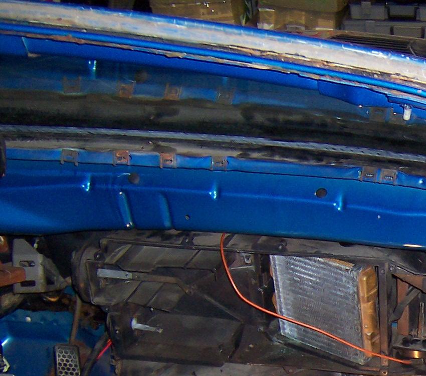

how to remove these? and what r they?
Old Jan 19, 2005 | 06:49 PM
WILL85IROC's Avatar
Joined: Sep 2004
Posts: 952
From: PITTSBURGH, PA
Car: 85 IROC-Z Z-28, BLUE & SILVER
Engine: 5.7L & 5.0L
Axle/Gears: FACTORY
need help on removing these pieces.. thanks

in the 1st pic, this connector is on the rear hatch behind the back seat... maybe to tank or something... but its rivited in??? and i cant get it out... dont wanna drill it because i might blow something up or poke the tank...

Old Jan 19, 2005 | 11:30 PM
Trickster's Avatar
Posts: 6,127
Likes: 12
From: conway, s.c.
Car: 1989 Iroc-Z
Engine: 5.7L TPI
The one at the rear bulkhead behind the seats is the connector for the fuel tank harness. You can drill the rivets out without any problem, the tank is below that point. That black piece for the antenna just screws off either with an antenna wrench or a pair of needle nose pliers. BTW, if you are sitting there scratching your head wondering what an antenna wrench is. It is a tool with two prongs in it that fit in those little notches on that nut.
Old Jan 20, 2005 | 03:41 PM
lonsal's Avatar
Joined: Dec 1999
Posts: 5,964
Likes: 37
From: Hacienda Heights, CA
Axle/Gears: 3.45, 3.27, 3.27
Use a drill bit that is just a little larger than the hole of the rivet to remove the connector. You don't have to drill all the way through the rivet, just enough to cut off the head. Then use a straight pin punch to push out the Pop-rivets. Re-install it with aluminum Pop-Rivets of the same diameter and pull-up range.
I sell an antenna wrench to remove the antenna bezel nut.
Lon Salgren
Top-Down Solutions
Old Jan 21, 2005 | 06:47 AM
WILL85IROC's Avatar
Joined: Sep 2004
Posts: 952
Engine: 5.7L & 5.0L
Axle/Gears: FACTORY
ok, thanks. i'll try and gen one on payday
