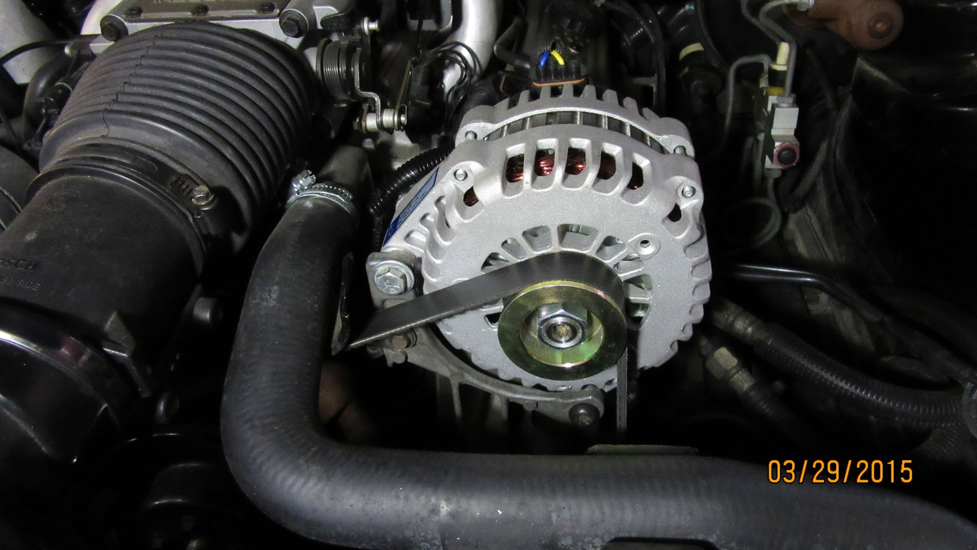

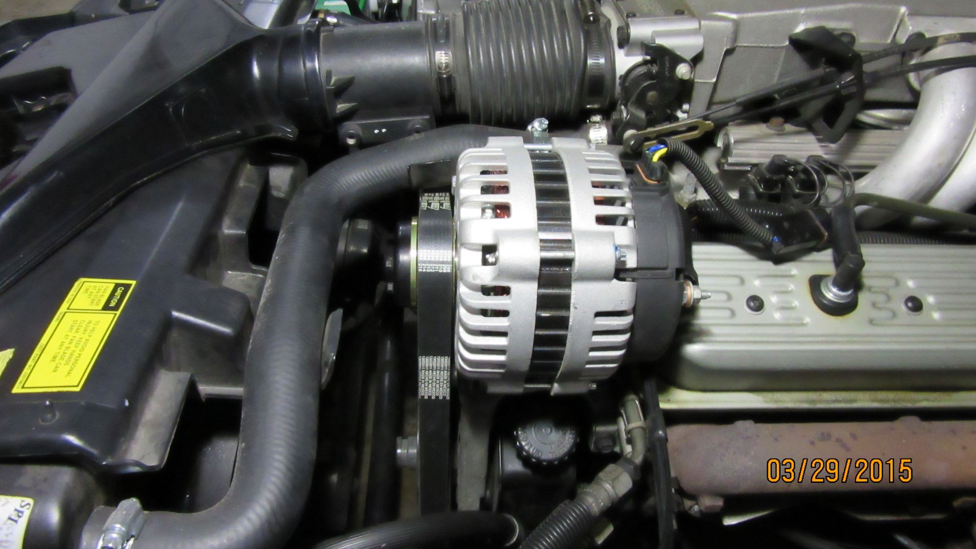

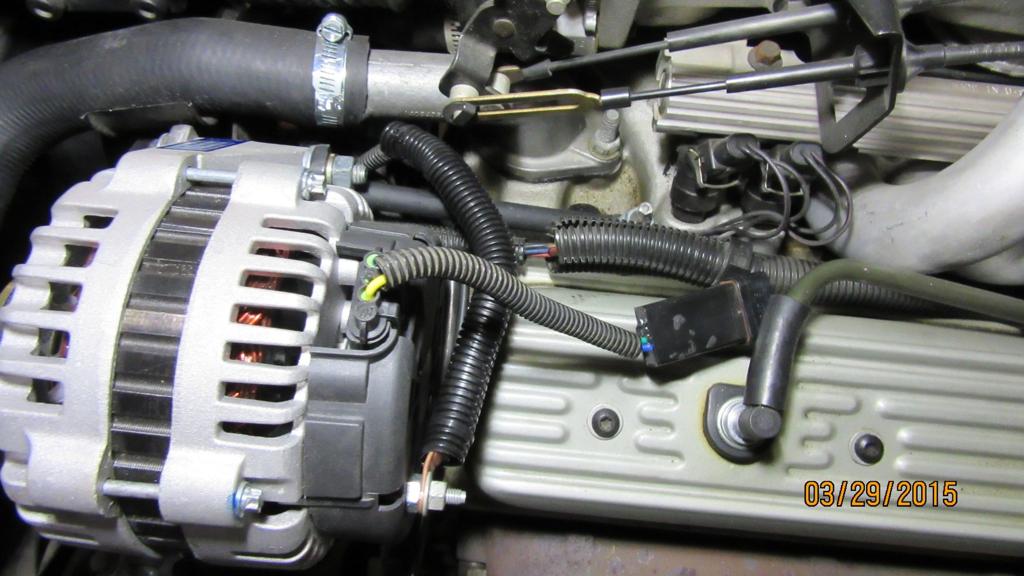

I can confirm that the AD244 will work. Requires slight elongation of the mounting hole and an adapter harness (only if you want to keep your stock harness unmolested). I will post further details when I get time.

Re: What's needed to put in a CS144 alternator ?
From what I can see in the pics, you can't use the rear support brace that goes from the back of the alternator to the exhaust manifold anymore?
Correct, these alternators don't even have that mounting point.
From reading about the swap on other forums people say that the AD244 case is so much better/beefier that the brace isn't really needed.
