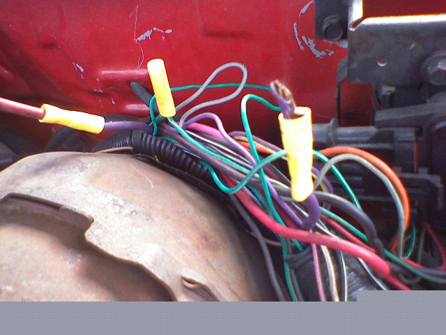

After sitting for three years, my passenger side power window will not move and my power rear hatch will not open.
Not the fuses, I already replaced them. Both worked when I parked the car. I have a bad feeling a mouse got to the wiring. These are the only two electrical things that don't work, and I find it odd that the switches are right next to each other. Do they share any wiring?
Other possibility is this:
Years ago, the electric engine fan stopped working, and the idiot mechanic that I took it to, rather than replacing the sensors and temp switch which had gone bad, wired the fan to a toggle switch in the interior. When they did this, they hacked up the wiring harness that leads through the firewall to find a power source. I recently took the car to my usual mechanic who fixed all of this fan nonsense the correct way.
There is currently a purple wire that was cut, and the hot end was connected to a yellow wire which now runs through the firewall. I'm pretty sure that I remember this wire going to the toggle switch that the idiots had rigged up, but it seems to lead back into a bundle of wires near the fuse box. Thoughts? Anyone know where I can find an accurate wiring diagram for these accesories?

So I checked today, and I am getting power to both switches in the console. Anyone have any ideas?

So, that purple wire? Definitely the power supply to the power hatch. Now it will pop, but the motor that is supposed to pull it back down is doing nothing. I remember reading several years ago that these power hatches are often problematic and people often replaced them with the regular non-power latch. Is this a simple bolt-on? I don't really need the power hatch, and I definitely don't feel like spending $460 for a whole new unit. Mine is an early production '91 with the A90 option, if that makes a difference in the compatibility of the non-power latch.

If your talking about the thick purple wire thats for the rear defrost.
