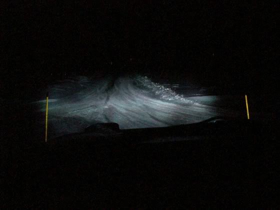

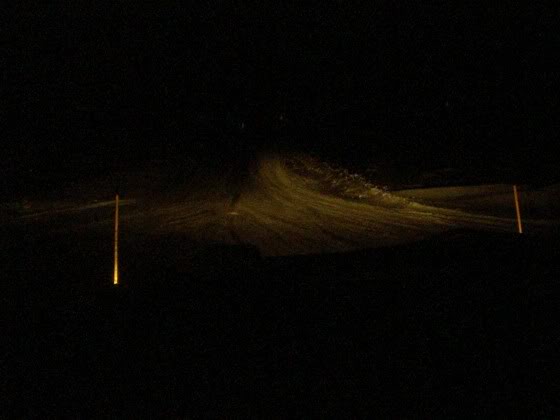

You can find HID's for less than $100, they're out there for under $70 to your door. They do throw out a lot more light, but for a fog light I would try to get either 3000k or 4300k color because a white/blue color will cause more glare in fog/rain/snow. A year or so ago I did some comparasine with my Jimmy. I had the stock truck lights and the HID plow lights. A link to the vid: http://s50.photobucket.com/albums/f3...DvsHalogen.flv

Nice, but is that comparing halogen low beams to HID high beams?
I have Silverstars & the difference between highs & lows is like that too.

That side by side I did was low beam halogen to low beam HID. The housings kinda suck for HID's unless you have or get projector style stuff, because excess light gets thrown upwards making it look like high beams. I got mine from an ebay company that goes by something like HIDoutdoorEquipments. I'd just make sure to get a set from a company that sells a ton of them and/or offers a warranty, for that just in case scenario.
