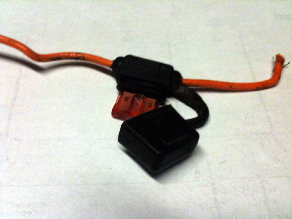

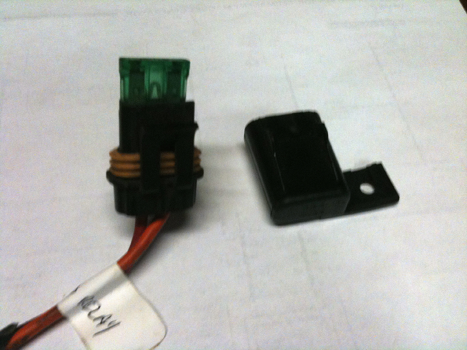

here is a photo of a removable fuse link. I will send a photo of the other white 1 inch long in-line cylinder type when I can get to one.
Attached Thumbnails Electrical Disaster-img_0132.jpg   Electrical Disaster-img_0133.jpg
