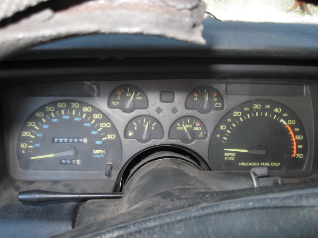

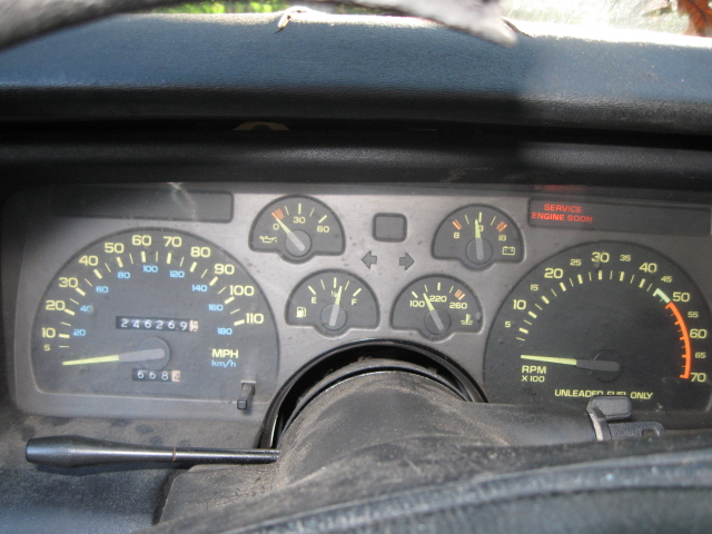

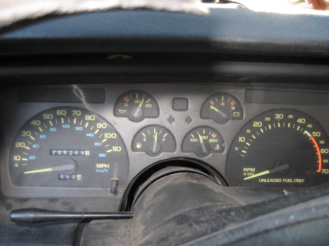

The first one is car off...second is car switched on...third is engine on.......thats all the Tach does...anybody know whats wrong with it?
