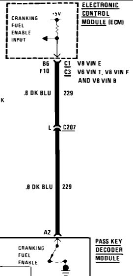

Shamelessly stolen from another thread I wrote this for yesterday:
Per the following images, use a solderless splice, a bit of wire and an eyelet terminal to ground black with yellow trace #625 in the first diagram, and dark blue #229 in the second to a good chassis ground. Chances are, there's a wire screwed to the floor or firewall near here anyway, use that. This will bypass VATS on both your starter and your fuel pump, as all it does is ground these circuits when the correct key pellet is inserted and the key is turned to start.
Full disclosure: I haven't done this yet, I'm going entirely on the diagrams to figure this out, but I'll be doing it on my car in a few days when I get my new steering column.
Careful, this is not entirely true. The fuel pump is NOT controlled by VATS.
What VATS controls is the SER (Starter Enable Relay) and the injectors.
The SER can be easily bypass the way you suggested. But the ECM requires a specific square-wave signal on the dark blue wire input to enable the injectors. Simply grounding that wire won't help.
VATS was a pretty useful and advanced system for its day and still prevents many auto thefts even nowadays.
Hope this clears up any confusion.
Lou

My bad, Lou. Thanks for the clarification. I'll have to revise my method. I think someone makes a module to wire in there, though, now that you mention that though.

You are right, you can buy an aftermarket module to simulate the VATS box signal for the ECM. They are getting less expensive nowadays.
Another option is to burn an ECM chip with VATS disabled.

Found the module in case anyone is interested. WAY cheaper than a correct year column (I just spent $300 on a rebuilt one for my 91.)
http://www.summitracing.com/parts/PRF-64024/?rtype=10
Looks like it likely installs at the location I indicated in the second picture, and shouldn't take more than a few minutes once you track down the wires it connects to.
