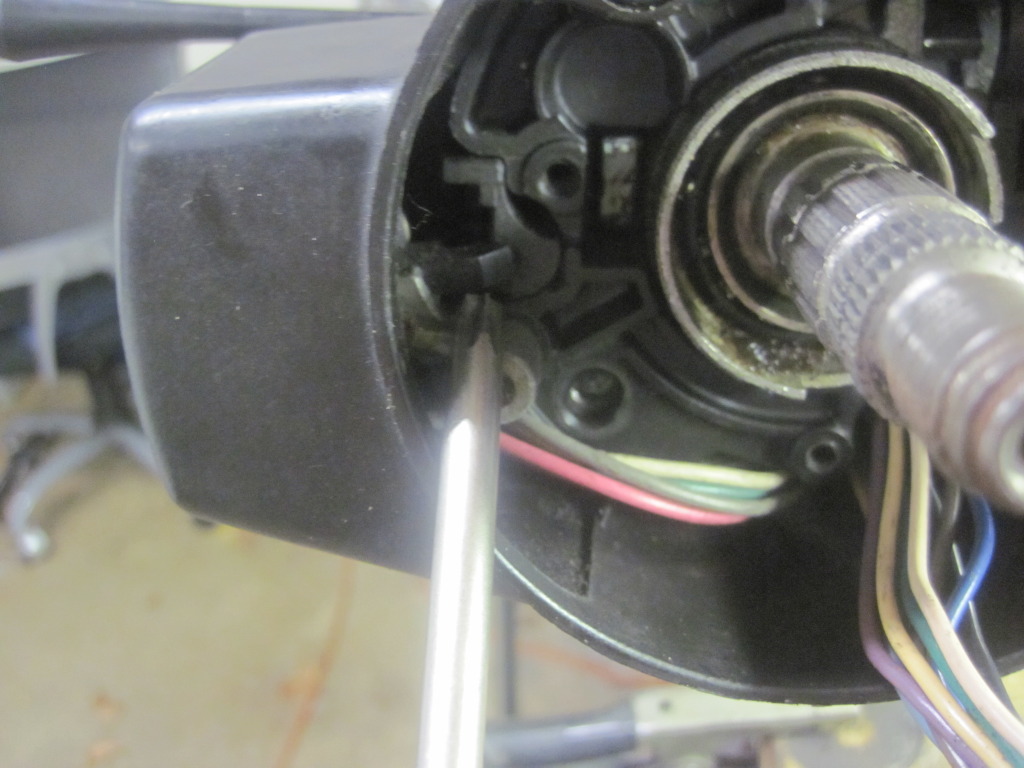

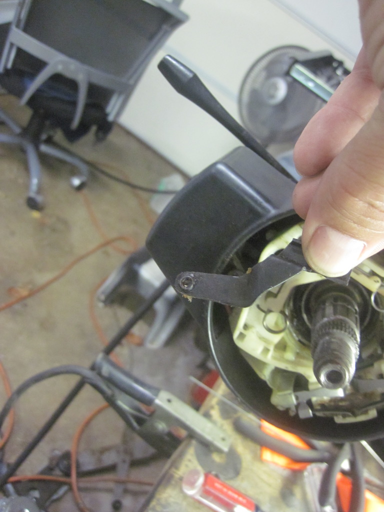

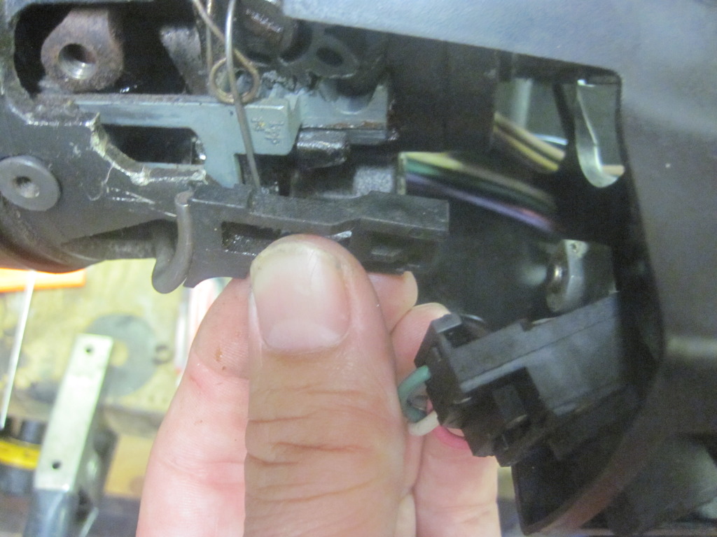

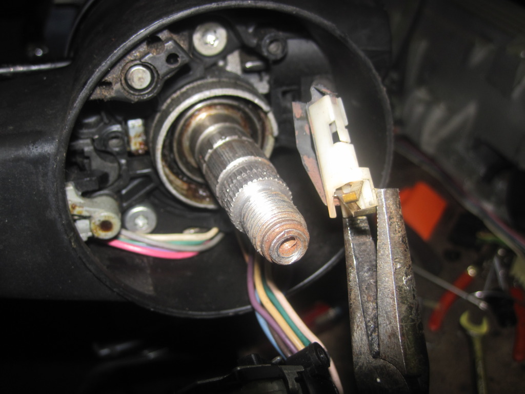

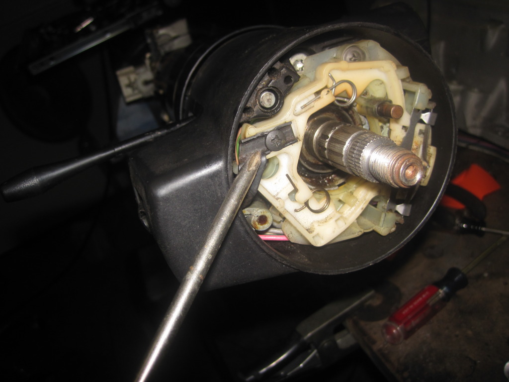

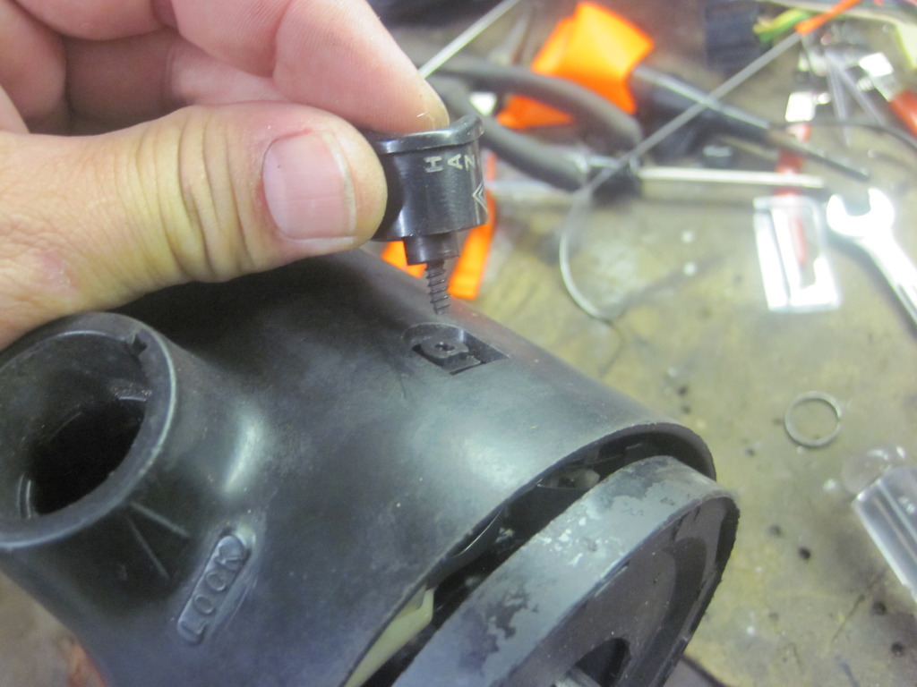

OK I will start after the steering wheel has been removed, and airbag activator removed, maybe. I removed my airbag parts about 2 years ago. but all airbag parts, & wiring are yellow or raped in yellow tape.
With steering wheel removed, you will need a tool similar to this to compress, the spring and be able to remove this locking spring clip. you can see the grove that it goes in, and yes it can be a pain.
remove the flasher ****.
remove the wheel looking ring, there will also be a white plastic ring with a copper ring.
one screw holds this in, it connects the signal arm to the signal switch / auto canceling mechanism.
and three screws that hold the signal mechanism in place
you will need to remove this doodad? or what ever the technical name is. it will just pull out.
with that out of they way you will see a black torx #15
with that removed.
you then can remove the tumbler.
Old Nov 2, 2012 | 03:22 AM
FlyDoc's Avatar
Joined: May 2008
Posts: 304
From: Planet Oahu Hawaii
Car: 92 RS
Engine: 94 LT1 383
Transmission: T56-6 Speed
Axle/Gears: posi, 3.26:1,
Re: New Switch For Brights
then remove the three silver torx #30's
this is the top of part that may be the problem, or its the small tab that extends over it.
now you will be able to slide the upper sleeve up.
which allows the lower turn signal cover to be removed.
this is the plastic intermediate part that may be your problem, but I have never seen one break, but have seen the lower signal cover damaged allowing it to come out of position.
this is how it is positioned on the lower signal cover.
/IMG_0524.jpg[/IMG]
this is how it sets against the rod.
here is it in place with the lower signal cover off, and the upper sleeve in place.
now just reverse to put it back together.[IMG]http://i1211.photobucket.com/albums/cc424/FlyDoc
