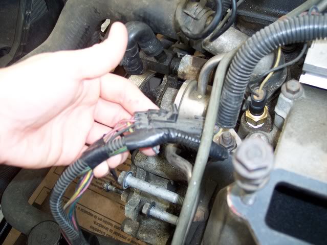

I'm only answering this after doing it twice before because I have had two teenagers and I'm used to it. There is a treaded hole by the thermostat housing in the intake, that would be where it goes. You may still have one in there.
It is the shiny brass sensor in the pic.
The wires in the guys hand have nothing to do with it, just a pic from the web.
