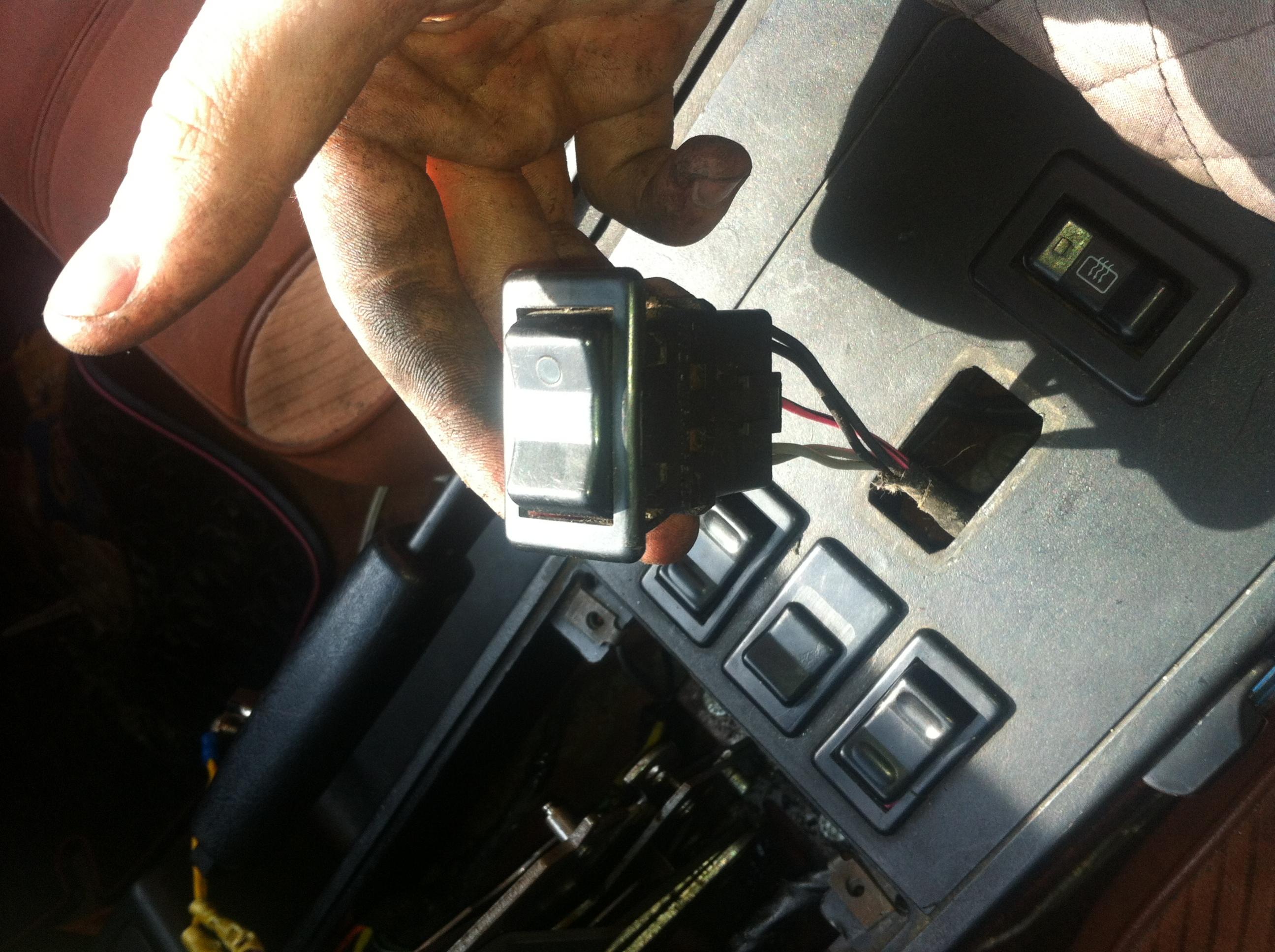

what is this switch for

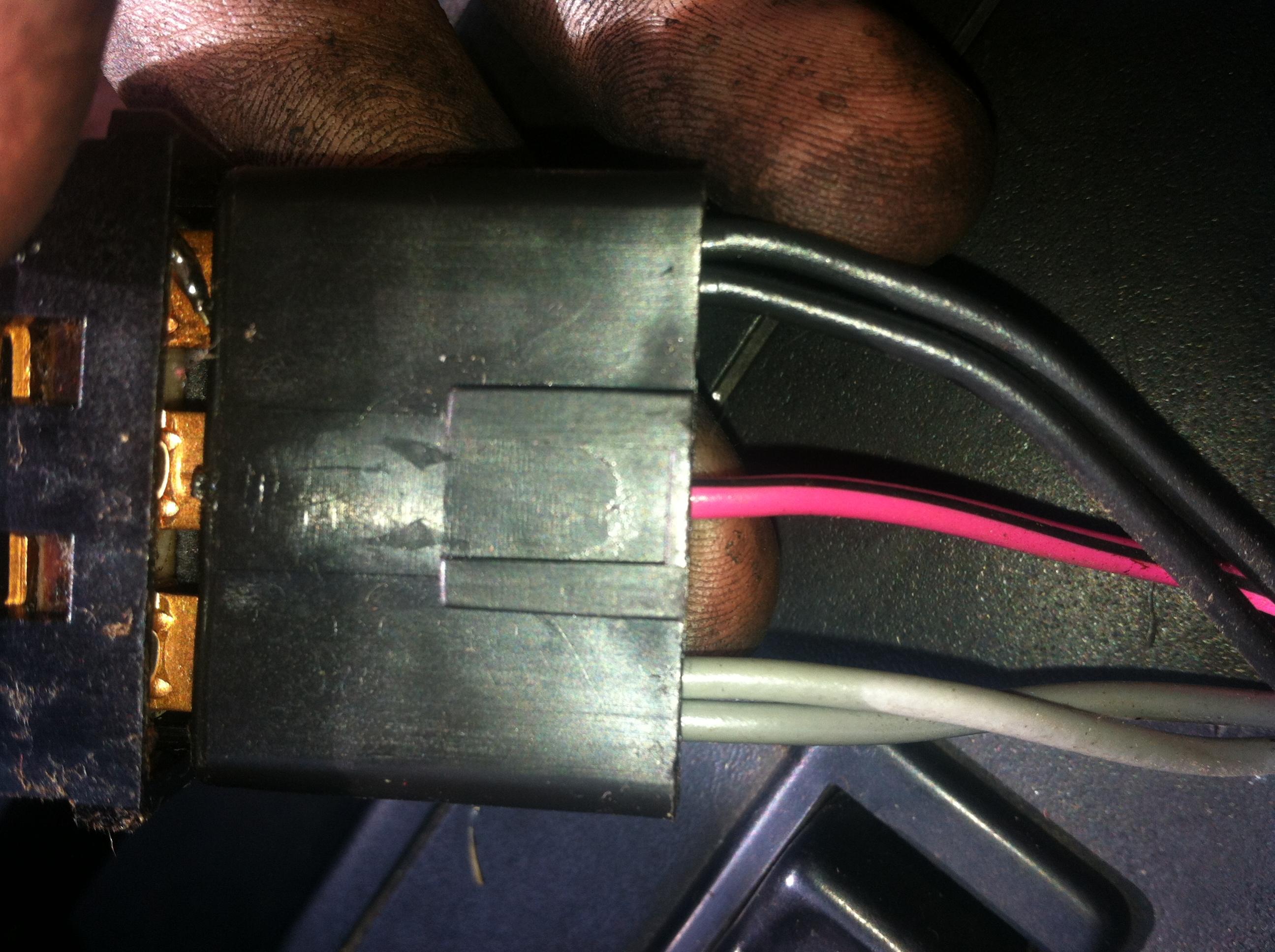

what is this switch for on my center console its by the electric window switches it has 2 gray wires and 2 black wires and 1 pink wire with a black stripe heres pictures

I think that switch is for one of these options:
1. Rear Wiper Washer
2. Cruise Control On/Off
3. Fog Lamps
Based on the wire color code, I think it's for the cruise control.

That's wild, cruise in the console and not on the turn signal lever! It would be easy to tell if it's one of the three, do you have a rear wiper, or fog lights? If yes to either of those then that would be it. If no, it would have to be cruise.

so i have a berlinetta which means my cruise was behind the pod radio but the cruise was removed by PO and i have no rear wiper/ wiper fluid and i have no fog lights

ok so i figured out it was for the cruise control but the PO didnt take out the switch or any of the wires

Looks like rear wiper switch to me. Cruise is horizontal mount on console Both from ebay auctions first is wiper, console mounted. Maybe hatch was changed?

But then there's this for 84-86 cruise in a Ber. Colors look right.

It's a cruise control plug,.....
84-86 Berlinetta's had a cruise control "ON/OFF" button that was possibly mounted in 2 different locations. Most of them were placed on the "filler panel" behind the radio ( horizontal mounted button ) but some were factory mounted on the top of the center console ( vertically mounted button. )
My Cruise button is on the second row down and on the right.....
