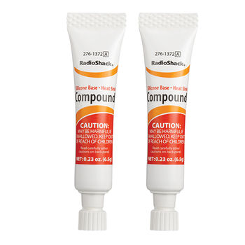

"You also want to make sure you're putting that grease on the new one when installing it."
^^^^^ What he said.
Go to Electronics parts store and get some good silicon heat sink compound for $5.99.Ignition Control Module keeps going bad!!!!-silicon-base-heat-sink
