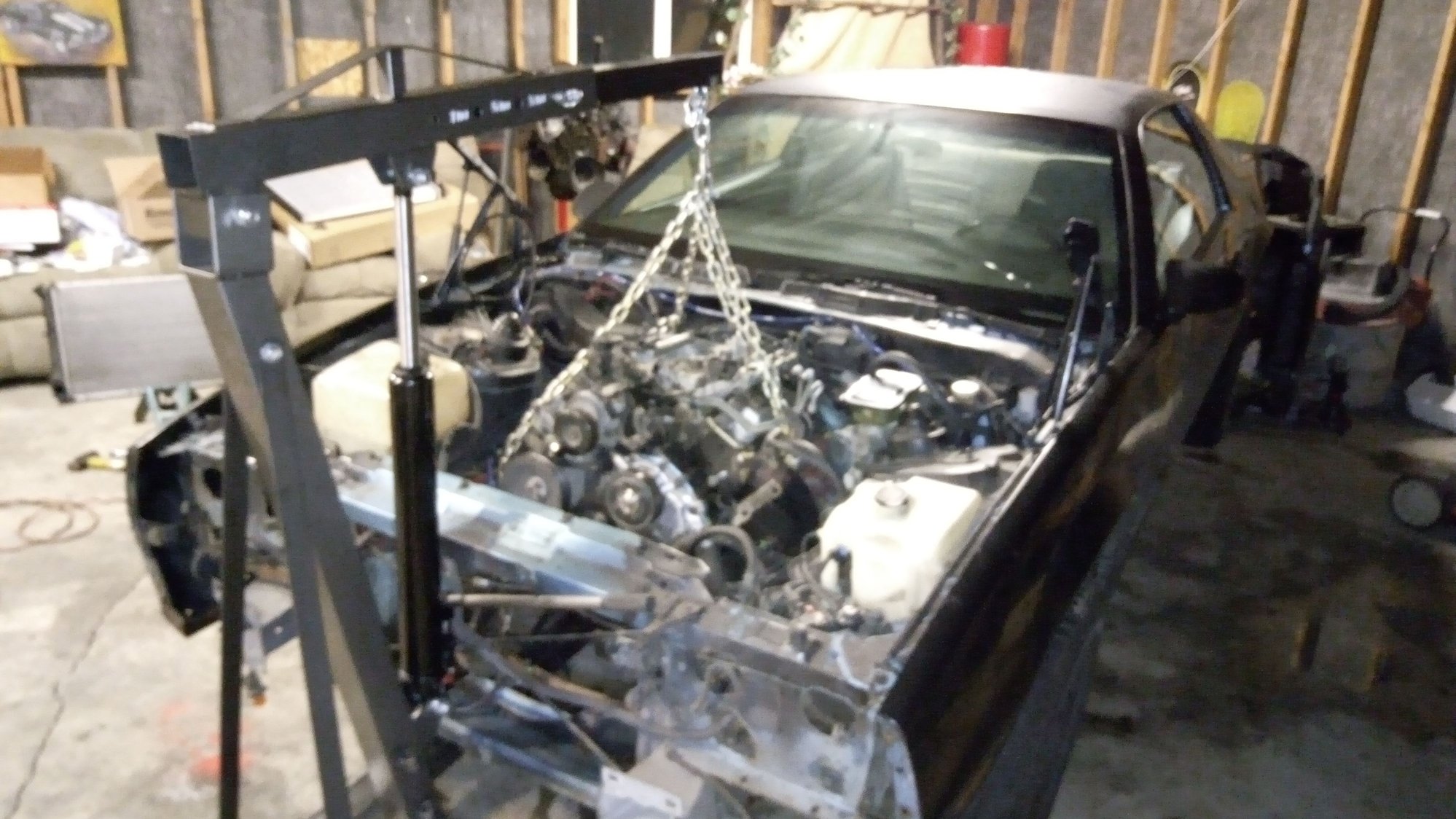

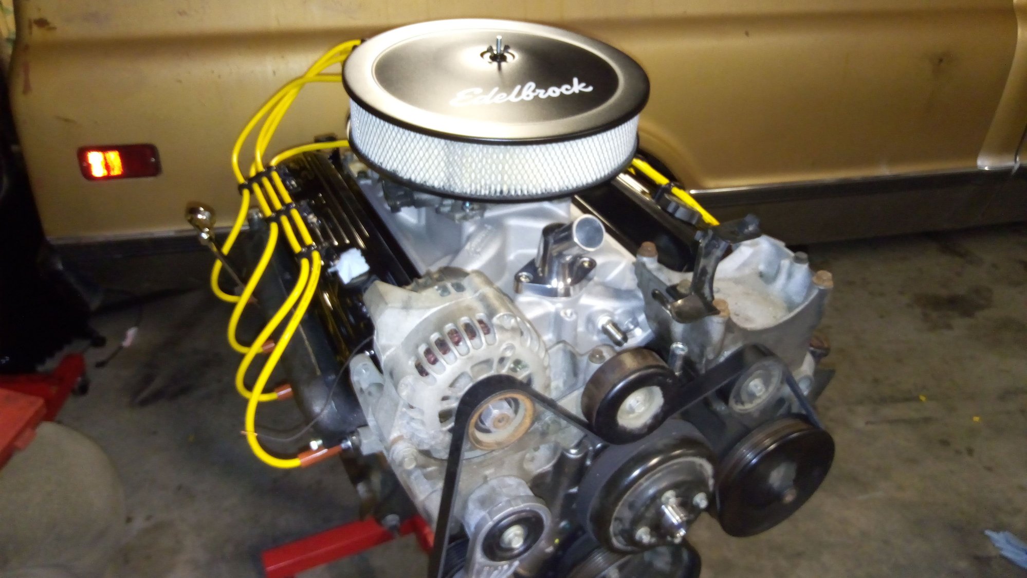

I find it weird that the switch worked once and then suddenly stopped after the first run. but anyway heres a few pictures and a little clip of it running! The tahoe I bought for 550 that the motor was in.
Bye 2.8! (I know terrible photo!)
The beauty that is now in it!
