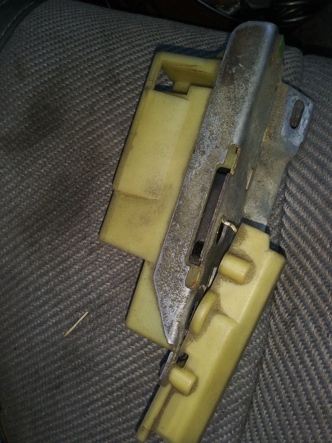

so the security light turns on but i don't hear the fuel pump turning on. Im going to mess with the rod and get it to turn with the key
Old Jan 27, 2019 | 02:24 PM
Luis_90iroc's Avatar
Joined: Jan 2018
Posts: 24
Re: Possibly vats ?
So there are 2 rods , theres one that is turning with the key and the other that isnt .the one that isnt turning is is touching something that resembles a button.is that how its supposed to be ?
Old Jan 27, 2019 | 03:01 PM
Joined: Jan 2018
Posts: 24
Re: Possibly vats ?
Is it possible where the rod goes on this isnt in the right spot ?
Old Jan 27, 2019 | 03:03 PM
Joined: Jan 2018
Posts: 24
Re: Possibly vats ?
Also on the starter im not getting power to the smaller wire, i gave power to that smaller wire on the starter and it spun. What is my issue there ?

Lets start with the basics.
Your security light comes on with the ignition. Does is stay on or turn off with the ignition on?

Re: Possibly vats ?
Ok so you do have a vats problem.
forget about anything except vats.
Double check your vats connector and double check your keys.

It comes on for 2 seconds then shuts off. If it stays on then VATS is enabled and cuts power to the fuel pump and doesnt energize starter enable relay.

Since you dont have the original tumbler what I would do is check the old key and new key and make sure they are the same. If they are then make sure the wires coming from the new tumbler are ok and not broken. (Unplug the wire from under the dash and with the new key in the ignition check for continuity) this will tell you if your wires and key are all intact and operating
