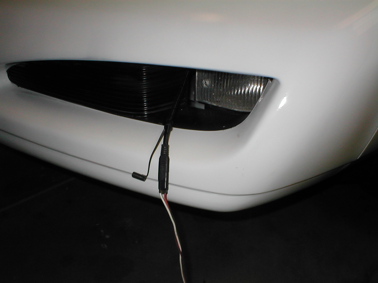

Battery Tender. The BT Jr works decent, when they start alternating blinking red - green - red - green - red - green, they need the capacitor replaced. After having 3 of them go ****-up the same way, and replacing them, I replaced the the capacitors, now I've got about six of them hooked up to my cars. Even got one of the cheap Harbor Freight copies around here somewhere. It seems to work as well as the real thing, but is notably lighter weight. If you mix the brand name Battery Tender and the HF, just know that the HF has the polarity (wires) reversed. This is easily fixed by opening the wall wart and heating up the solder, removing the wires, then soldering them back in reversed. Either throw out the HF attachments, flip the red/black boots, etc since they'll be marked backwards at that point. I hacked up the HF adapters and used them to make custom adapter harnesses for my cars.
