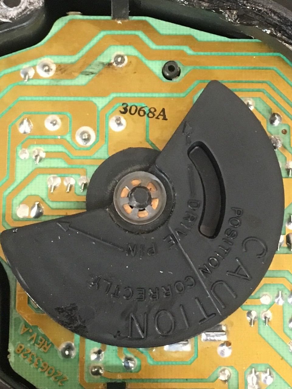

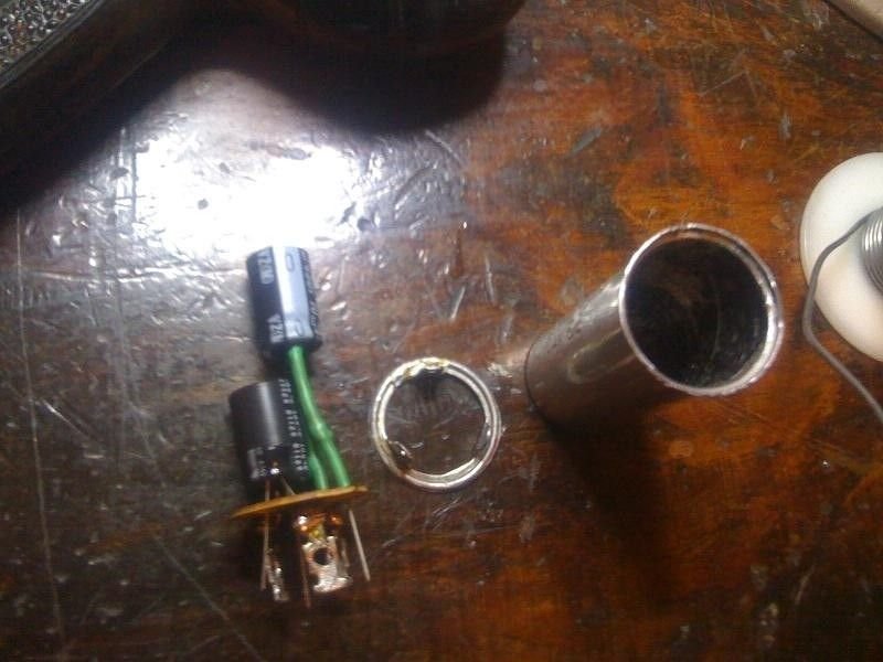

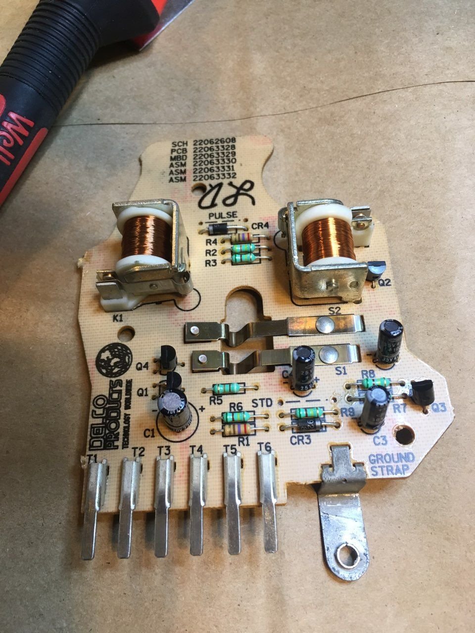

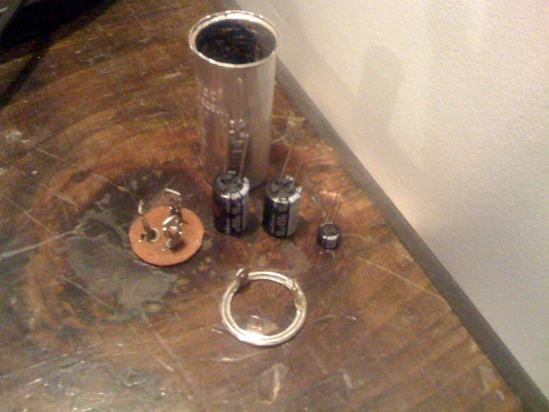

Here's how I fixed my delay wipers
So , my delay wipers weren't working . The exact symptom was that the regular speeds worked fine , the wipers would properly park themselves when shut off , but in the delay mode the wipers would rise up from the parked position into the waiting to sweep position like they should , but then would never sweep . The wiper switch and the variable resistor checked out fine . So I took the cover off of the wiper motor , removed the very delicate spring clip holding the black round switch actuator on and removed it , and then unclipped the board out of the outer case (it holds in on two molded in plastic catches , one of them you can see at the very top of my first picture)) . There are four transistors (Motorola M8467) on the board whose numbers come back as unobtainable from my local electronics supply house so I had to pray it wasn't any of them , I really wasn't up for chasing down some close enough substitutes . There are three diodes which the diode check function of a modern digital meter verified as good . The two relays similarly checked out fine (good coil resistance and clean not burnt/pitted contacts) as well as the two switches , S1 and S2 , their contacts looked great . There are a handful of resistors that all looked OK and indicated close enough to proper resistance , so then the final parts roundup brought us to the four capacitors . Their values were 220MF @ 10V , 15MF @ 25V , 10MF @ 50V , and 4.7MF @ 35V . My local electronics supply store did have pretty much what I needed with the exception of the 15MF which a 22MF was the closest they had , the new values being 220MF @ 25V , 22MF @ 25V , 10MF @ 100V , and 4.7MF @ 100 . These four capacitors cost a grand total of $2.82 and lo and behold when I installed them and reinstalled the board the delay wipers now work ! A close look at my second photo shows where capacitor C3 appears to have leaked out it's goo (electrolytic paste , it's the cloudy looking stuff covering the label for R9 and running under R7 and R8) and was likely the only one that was actually bad . Now just so you know , the values not being 100% exact are OK , with capacitors you can always go higher on the working voltage with no problem whatsoever , you just can never EVER go lower on the working voltage as the poor capacitor is then being operated above it's max working voltage , they usually pop open (sometimes really loudly) and spew electrolytic capacitor goo all over the place when asked to tolerate more voltage than their rated for . As to the actual capacitance , the working tolerance on electrolytic capacitors is usually quite high , sometimes on the order of +100% / - 50% , so the 22MF substitution for the 15MF is fine and well within standard tolerance norms . Anyway , it works again and I hope I've given some of you electronics minded people the info you need to fix yours (if your symptom is the same , that is)
If any of you have any questions feel free to ask ...........

Here's the part numbers of the 4 capacitors

Good job. I used to fix computer motherboards, mostly Dells, and there was one model that the whole line of capacitors on the board would fail when they got older. The can would bulge at the end, the tell tale sign, and 9/10 it would fix the problem

Thank You Scooter , It would appear that capacitors are the bane of electronics , both modern and vintage . I restore antique tube radios from the 1920s through the 1950s and the old caps are SO bad it's common in the hobby to "shotgun" replace every cap in a newly found set before powering it up (radio hobbyists call this a "recap") . The old caps usually die shorted instead of open , then when powered up they draw destructive amounts of current through other associated circuit components like RF coils and the like which can be impossible to find replacements for . Sometimes when dealing with a particularly valuable radio where looks count and not wanting to ruin the original look of the chassis an old capacitor will get gutted and a new cap installed in the old case . This was a three section old power supply filter cap that I restuffed with three modern replacements to preserve the original look .

Good to know, both the tip to not power it first, and also to hide the new caps in the old can for asthetics

You can also order all kinds of capacitors and other electronic components from Digikey, Mouser (who carries the full line of Aptiv connectors as well), Jameco, etc.
Electrolytic capacitors have ratings in ripple current, effective series resistance, °C, and hours of lifetime, as well as their capacitance and voltage. Nowadays there are ones specifically qualified for automotive use... considering that in an auto they have to function from -40°F to 200°F, whereas ones for home or even industrial electronics don't cover anywhere near that range. That qualification is called AEC-Q200 (for passives... the same organization publishes others for active components). It didn't exist in the 80s; which is probably why so many of them fail so much. Interestingly, one of the main criteria is vibration and shock resistance; something that home or commercial electronics hardly ever have to face.
I would STRONGLY recommend that Q200 parts be used for this. Otherwise in a year or 2 you'll be right back to where you started all over again.
Here's a link to Digikey for example, filtered for AEC-Q200, automotive, polarized, and through-hole. Check out the range of hours vs temp ratings that are available in that group.

Sofa makes a great point about using the best rated parts for longevity . I had thought of ordering the caps on line but that would have meant having no wipers till they showed up . This being a daily driver my thought was that if the off the shelf caps live even half as long as the originals did , it'll very likely be longer than I'll be driving it . If they die sooner than I do , well then I'm already well practiced in their replacement
And now that I've agreed with you about the wisdom of the best rated components for maximum longevity , as a point of conversation I gotta ask , do you think the underhood high temperature of a car gets that much hotter than the internals of my first pic when it's mounted in it's cabinet ? And surely whats in my second pic vibrates more than anything bolted to the body of my car , hopefully ? Not needling here , I'm just truly curious which really is the worst environment for our poor capacitors to endure ? The car wins 100% in the widely varying temperature conditions capacitor torture test for sure , but tube amps , especially high powered ones , are known all too well for pushing the design limits of their components , tubes and capacitors especially , to produce "That Tube Sound" that still has a huge following today .
