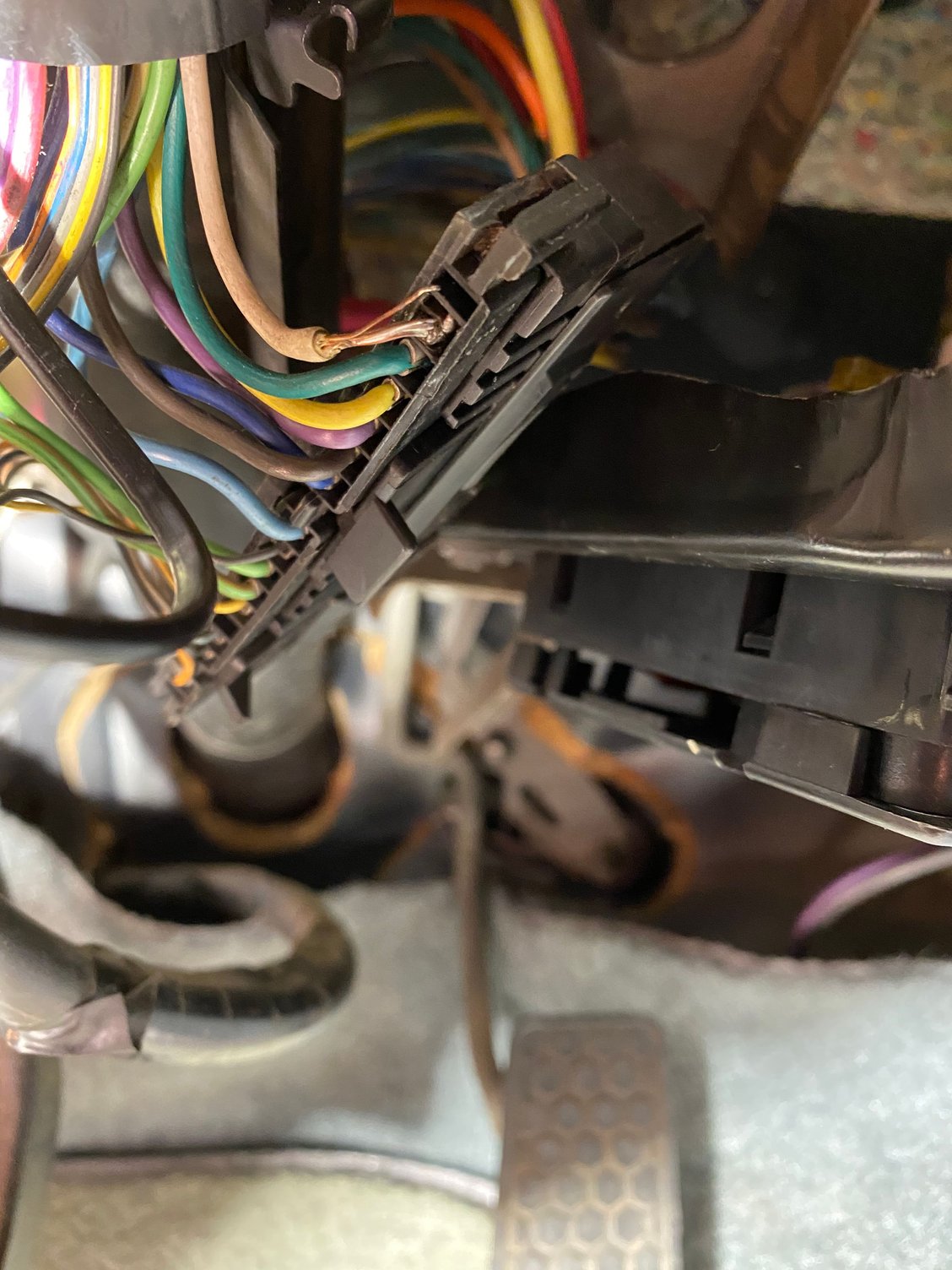

I found this horrible solder job under the dash while removing my broken door chime and installing a radio retained power module this week.
Does anyone know what this particular wire might be leading to? I need to re-pin it.

That is the C210 Steering-Column Connector for Exterior Lights/ Stop Lights/ Hazard Lights, Etc.
The Wire that has some conductor showing is in the "P" Terminal Position.
It should be a White Wire...
and it goes to the C208 Connector next.

All my lights work but the front side markers. Would they be tied into this connector as well?

Is that connector for the signal light switch?

Are you still working on this?
The Wire that you asked about is part of the Stop-Lamp/ Brake-Lamp (NOT Tail-Lamp) Circuit for Trans-Am Cars...
C210 Terminal: "P" (White Wire at the C210 Connector; changing to a Light-Blue Wire at the C208 Connector).
This circuit differs for "Base Model"/ Firebird Cars (NOT Trans-Am/ GTA Cars).
Front Side Marker Lights (One in each Front-Fender) are not part of the Circuit that we are discussing above.
The Two Circuits for the Front Side Marker Lights, do go through that same Electrical Connector (C210)...
but they use different Terminals:
-Left Side Marker illuminated by C210 Terminal: "H" (Light-Blue Wire).
-Right Side Marker illuminated by C210 Terminal: "J" (Dark-Blue Wire).

The Wire from the First Image that you Posted, is C210 Terminal: "P".
It is part of a very simple and short Circuit.
Here is the entire Circuit... layed-out as follows:
-Connector C210, Terminal: "P" (White Wire) on Steering-Column to Connector C208, Terminal: "A" (White Wire).
-Connector C208, Terminal: "A" (White Wire) behind Driver-Side Kick-Panel, splits into C208, Terminal: "B" (Light-Blue Wire).
-Connector C208, Terminal: "B" (Light-Blue Wire) to Brake-Pedal Switch, Terminal: "A" (Light-Blue Wire).
-Brake-Pedal Switch, Terminal: "B" (Orange Wire) to the Stop/ Hazard Fuse (Orange Wire).

You can get the correct terminal crimp on end from a terminal supply, ive done it, they will slide out with a very small screwdriver.
