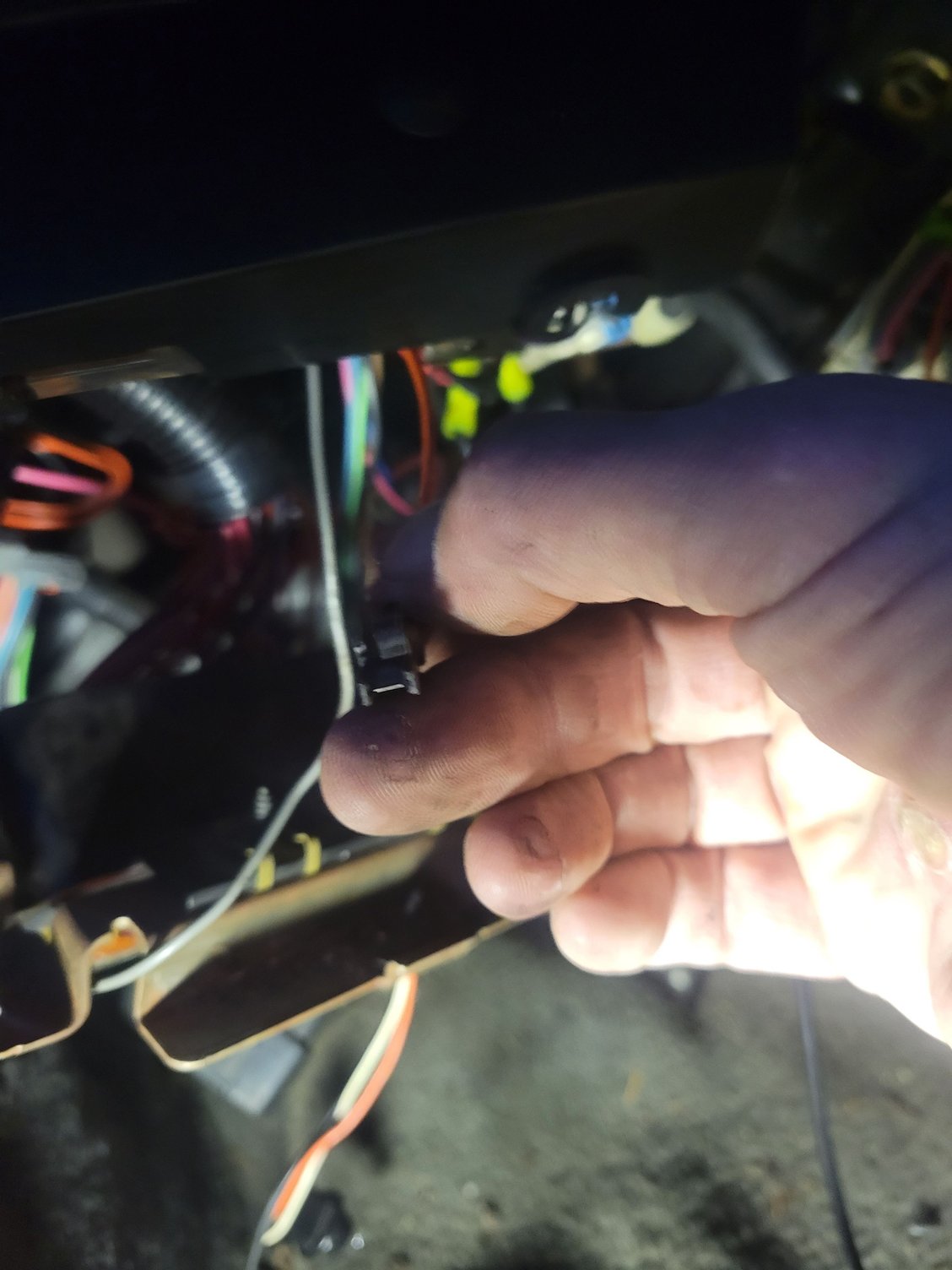

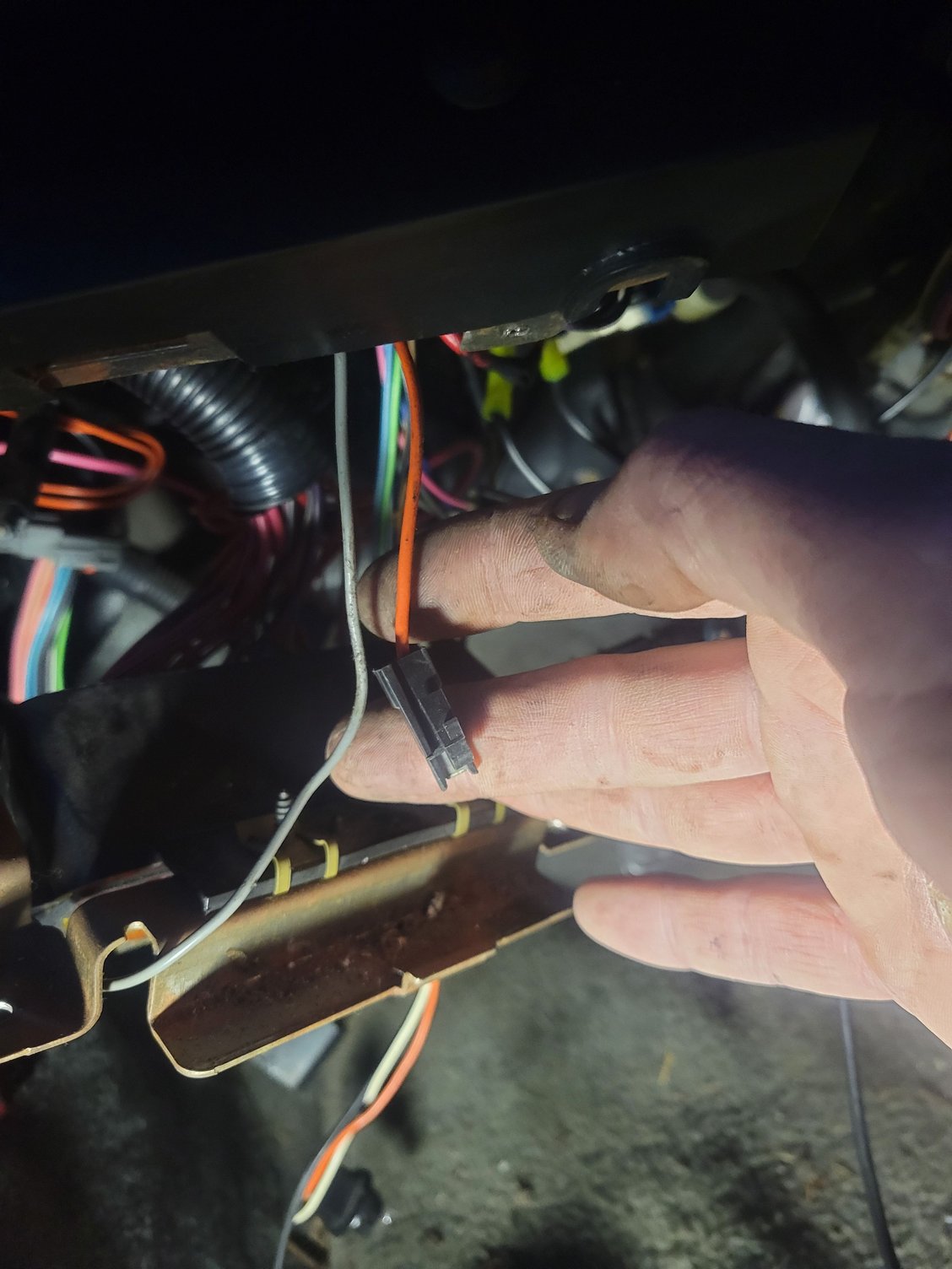

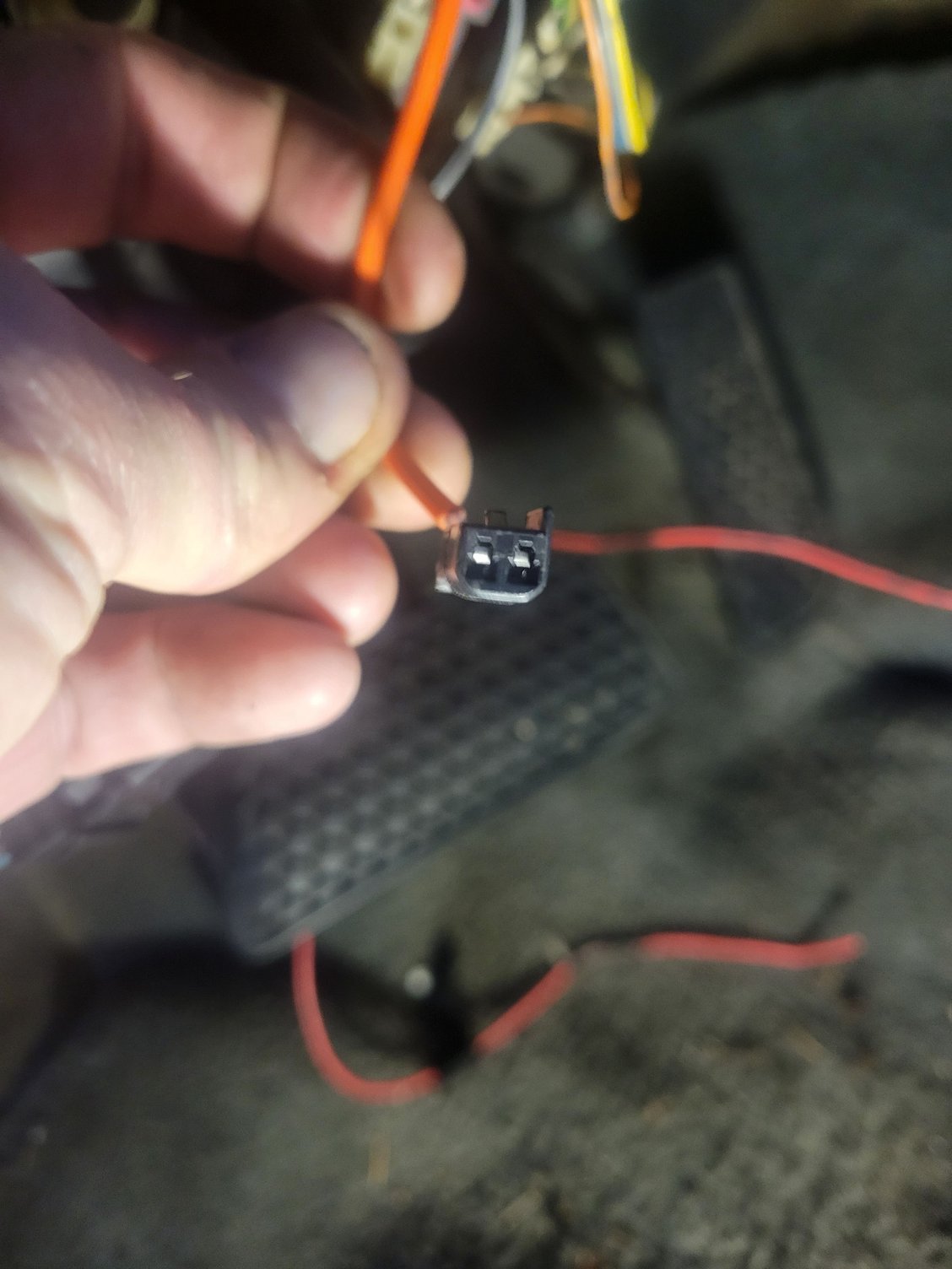

Can anyone tell me where these 2 oranges are supposed to go on the driver's side kick panel????
2nd and third pic are of same wire.

The First Image is of the VATS Ignition Lock Cylinder Connector.
The Second Image is of the Accessory Power Connector that Plugs in on top of the IPBEC (Fuse Panel).
