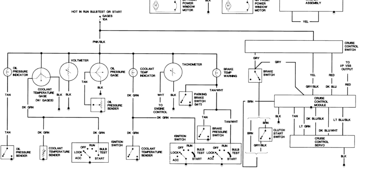

Tempe gauge pegs when connected directly to a ground using the green wire I've rung the wires and this black wire in the picture also goes to the back of the gauge so I assume it's a ground not sure if this wire also has to be hooked up the car calls for a one wire sender 1984 Camaro 305

Ahh look at that drawing i bet i know what you got going on there! The right diagram incorrecly labels a switch a sensor or sender. This is really a switch that turns on at lets say 210F or high temp then passes a ground to light up the lamp on dash.
The diagram on the left shows a model that had guages and would use a different sender.
that being said, Your most likely buying a switch and not a sender. The wire to the ignition switch is optional. This would apply a ground to lamp test and sweep the guage.
you can verify this buy the symbols on the diagram for the senders.
