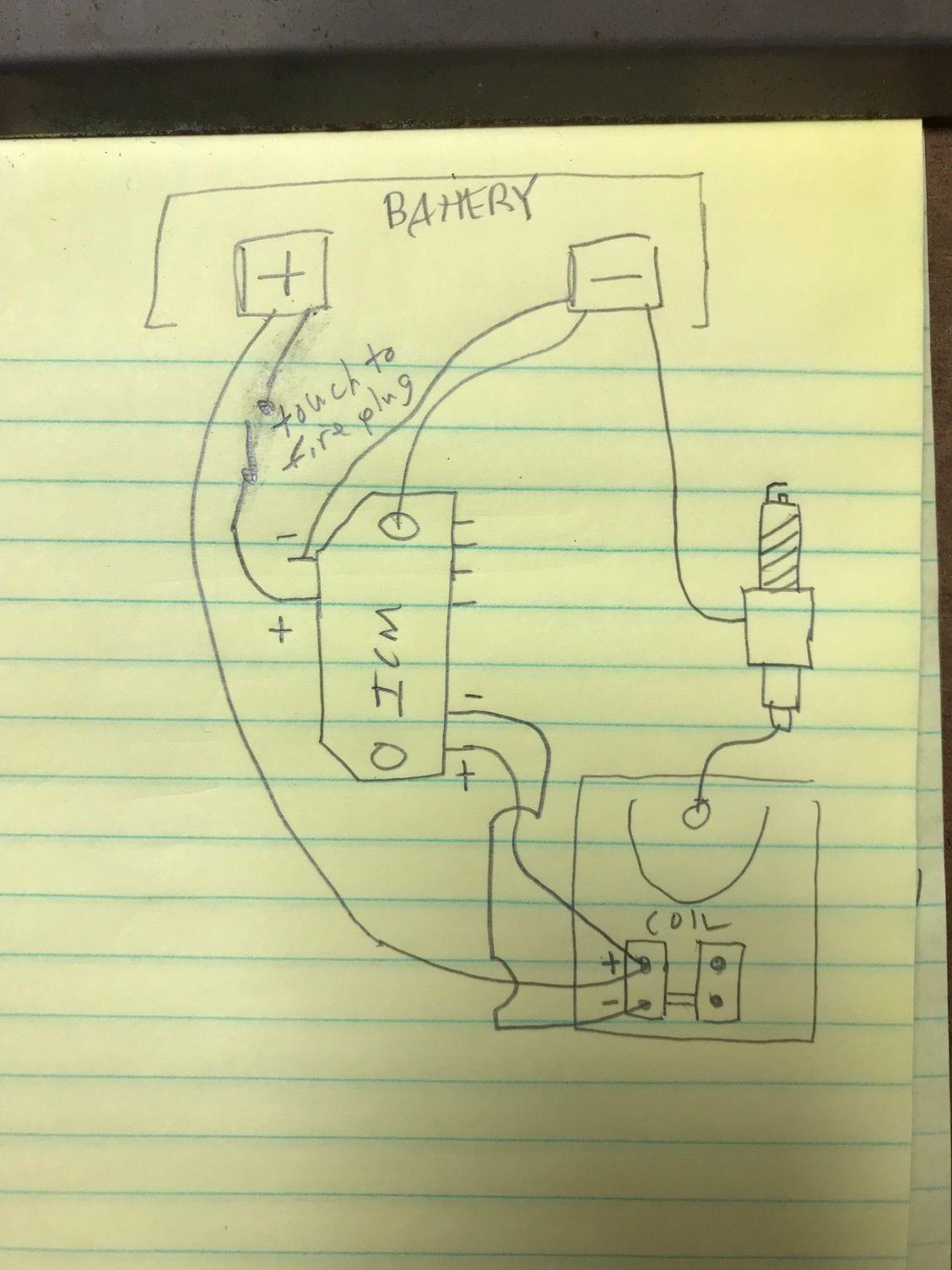

Another chase in progress to find out if my ICM and coil is good or not.
This thread https://www.thirdgen.org/forums/tech...st-my-icm.html thread has the easy auto diagnostics link which does not actually test the ICM, it uses a process of elimination to presume the ICM is bad.
In the same thread @gw082008 suggests testing the icm directly with a rig off the car. I have created this rig, I would like someone (@gw082008?) to validate I have set it up properly. In do not get a spark in my rig. I have another ICM I will test with tonight.
Maybe I also have a bad coil in my rig, I also have a spare to swap in. Both coils pass the 3 resistance tests published elsewhere here.
I am most concerned that the rig is legit since I had to interpret what gw said and the FSM diagram too.

The only thing I see is that the battery ground to the ICM mounting eyelet. It may not be a good enough ground. Mount the ICM on a aluminum plate, which is needed for heat sinking anyway, and ground that plate to the battery.

The schematics are how I bench test my ICM & coil circuits.
Hope this helps!
I have a spare distributor so it makes it a bit easier to test.
Rbob is correct so make sure you properly ground the ICM.
New Years day my Firebird also stalled and would not restart so I assumed my ICM had failed.
Turns out it was actually the coil - it ohmed within specs but would not fire a spark plug.
Good Luck!

Now with my permanent no spark I believe i have my rig all set up outside the car (sans the 6A which failed a spark test) per my diagram and GW instructions including using an old dist as the base. I have attached a pic of the rig.
What I note:
* I could not get a spark from my two ICM's or my two blaster coils.
* I got a new cheapo ICM and coil this morning to get a baseline going.
* I do get spark with my cheapos, but it is nowhere near what the MSD6A/blaster put out.
* The cheapo coil gets warm to the touch after about 20 taps of the test wire.
It seems at this point I have two bad ICM's, two bad coils, and a bad 6A.
Should I be able to hit the test wire as fast as I want and get a spark every time?
Also, this is a twin turbo car, and I am at about 12 lb of boost right now. I want to dial in more, what should I do for a permanent solution regarding the ignition? Another 6A?

Just so I understand what I should be getting from the rig, every time I put 12v on the ICM I should get a spark right? It seems like I don't always. I also get residual sparks after I apply the 12v.
Maybe I should just bite the bullet and get ACDelco ICM and coil and use that as my baseline. Right now it's a parts store mixed setup. So annoying can't even get it to act predictably.

Update - installed new OEM stock coil and new OEM ICM. Still no spark. Grrrr. Following the attached diagram to step 5. Question - step 5 references Figure 1, see where I drew in the 8v power supply, where do I connect the 8v ground to?

I did not find an answer to my question above, but on checking my whole setup once again I found
1. the test spark plug/alligator clip combo was missing the electrode - maybe I was getting spark but it would not spark through that thing.
2. inside the dist the connector from the pick up coil to the ICM maybe had a pin inside the connector pushed back preventing a connection.
She started. Whew.
Remember you can test for spark with the plug wires off the dist cap and the dist cap off. Just ground via spring clamp a spare spark plug against something metal under the hood and run the coil to it.
I was recommended to find an ICM ending 369 printed on it but my new OEM ICM had a different number printed on it. I was also recommended to get an OEM coil made in the states but my new one had Poland, Mexico and China on it.
