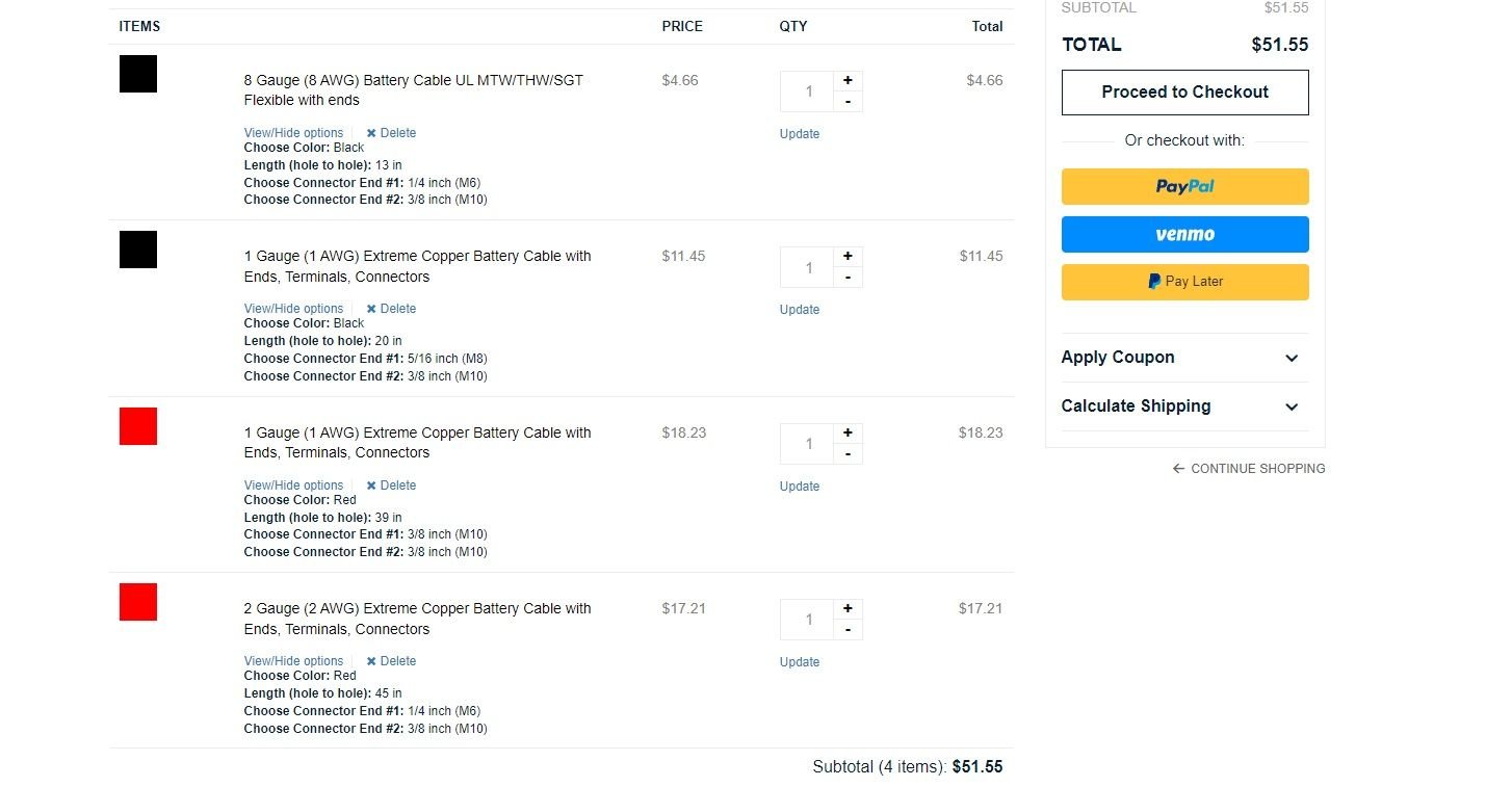

So I was thinking have this company make the cables with the correct lengths and eyelet terminals. Get a fuse holder and re-use those weather pack terminals. Get a pair of top post Military style battery posts. Bam. I added all the lengths for the negative and positive cables and it came out to like $60. So maybe another $30 in other parts and I am set.
