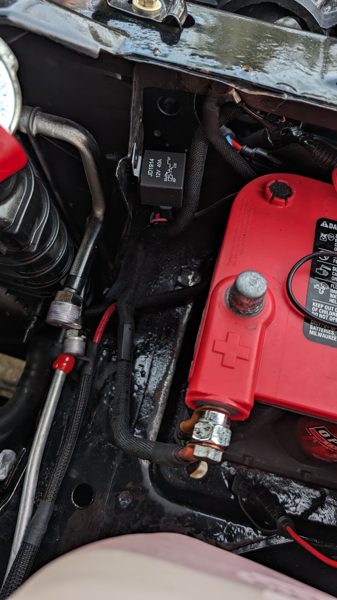

Hey guys, got a very interesting electrical issue that popped up and can't figure it out after diagnosing for a few hours. Here's what I know...
1985 IROC - Carbureted
Added after market electric radiator fan
Car didn't come with electric fan (I think) so I wired this to a relay that gets a 12v feed from the ignition when turned on.
Car sat for about 8 years, charged it up, and I noticed that the fan was not coming on with the ignition like it always has in the past. I've never had ANY issues with this setup and I haven't changed anything.
Multimeter came out, I see the signal wire only has .3v with ignition on and 0v with it off.
After a long diagnosis process, I realized that I have this fan signal wire connected to the choke heater relay.
Confirmed the relay is working properly on the bench.
I found that the ignition gives the relay's first pole 12v (from the C/H fuse), second pole is the choke heater device (now fan signal) at 0v, and third pole (from gauge cluster fuse?) is only getting the .3 volts.
The original wiring diagram shows the third pole that's getting the .3v coming from the gauge cluster. See highlighted attachment below.
I checked all the fuses and they all have 12v on them and all fully intact.
I really don't want to tear the entire harness apart trying to track this down... I don't even think I could with the small amount of space under the dash. Any one have any ideas at all where the heck this is fed from and why it would only have .3v with ignition on? Wiring diagram shows it is directly connected to the gauges fuse but like I said, checked all fuses and they all have a solid 12v.
Another thing I found while mind effing this is if I put the volt meter leads on a positive 12v pole and on the the third pole mentioned above, meter shows 12v. Could this mean its a short? Also, I did a continuity test between the third pole and all of the fuses and did not get ANY ringing from the multimeter indicating that the third pole is connected to any of the fuses. Super weird and I'm very very confused.
Also, side question... How the heck does the choke heater work? From the wiring diagram it looks like the choke it always on as long as the ignition and gauges are on. Something would need to disengage the choke one the car is warm, right? Maybe I'm reading it wrong... electricity is not my strong suit!
All help extremely appreciated!!!

UPDATE -
Just did a couple more checks and found the following...still no progress. Even more confused.
IGNITION OFF - RELAY OUT
1. Third prong female end has 0v
2. Second prong female end has 0v
3. First prong female end has 6v on it (Wtf?)
4. No continuity through the fuses and the third prong female end
5. C/H Fuse #4 & Heather/A/C Fuse #8 both have 6v on it with ignition off.
6. Getting -6v across the 2nd prong and the C/H Fuse #4. Same with the 3rd prong.
IGNITION ON - RELAY OUT
1. Getting continuity between the Choke Heater fuse and third prong female end
WTF?!

I added the wiring diagram with some markups showing what voltages I'm getting where. A photo of the relay I really don't think would be of any value. Let me know if you mean a photo of something specific.

Also, the fan relay I am running is a standard 4 prong relay that is set up to run if the ignition is on which I've never had issues with in the past. I have a complete aftermarket engine setup that doesn't currently have a temperature switch that I could use for grounding the relay. That being said, might be a good time to add one in cause this seems like a much more appropriate setup. The pink/black circuit is always on with ignition on, correct? So the relay wiring would be:
1 - Temp Switch (Ground)
2 - Black/Pink 12v Ignition Feed
3 - 12v Battery
4 - Fan
Any idea what temperature the stock temp switch is designs to activate at?

Wow! This entire situation was unnecessarily made to be very over complicated.
We are talking about a very basic, very small Electrical Circuit with nothing but One Single Pole Single Throw Relay.
I would make the Connections that you Posted, but with one slight change:
3 - 12v Battery
4 - Fan
For the very first attempt to Turn-On/ Power the Fan...
Instead of connecting your Coil-Ground Connection through the Thermostatic ("Temp") Switch, Connect that Wire directly to a very Good/ Clean Ground-Location.
As long as you succeed in Turing-On the Fan, you can proceed to go back and...
Making the Coil-Ground Connection through the Thermostatic Switch.
Most of the Original Thermostatic Switches did not close until a Temperature over 220*F.
Some of the Secondary Cooling Fan Thermostatic Switches did not close until almost 240*F.
Absolutely horrible for the Engine Cooling System longevity (and the Engine itself OVERALL).

Is the slight change you're recommending the testing prior to using the coil ground switch? Also, great point with 220* set point. Any recommendation of a lower set point switch out there that exists? 200 would probably be the right number I would think.
Thoughts on the Choke Heater power issue?

I was measuring with the red lead on the brown wire that goes to the volt light and the black lead on a body ground. I didn't believe the relay was operated correctly since I put a separate 12v feed on the brown wire (that was showing the .3v feed) and the relay snapped and the fan came on. After reading through you message though, this does make sense. It's just very very odd that this set up as it currently sits was working previously and just stopped...
I just ran into the garage and confirmed that I do not have the alternator hooked up to a brown wire. I only have the alternator connected directly to the battery and then connected to a slightly larger gauge red wire in the harness which goes back to the wiring harness C100 block and I believe is the power distribution to the fuse block. I deleted quite of bit when I dropped the new engine in about 8-9 years ago.

Bear with me here guys... I just peaked at my existing coolant temp sender (single prong). I have it hooked up in the passenger side cylinder head to green cable which gets lost in the wiring harness. Will need to do some investigation to find out where exactly it goes... That being said, does anyone have a wiring diagram for a 1985 radiator fan relay everything I'm finding on austinthirdgen and other thirdgen.org posts don't show a fan relay. It does show a temperature sensor connected to the ECU but its a two prong and goes to yellow wire. Maybe this explains in my other post why the gauge may be reading inaccurately? I swore I replaced this with exactly what it had prior to the engine swap which was a single prong temp sending unit.

Factory fan relay, if your car has it, should be on the firewall near the brake booster.
Temp switch wire should be dk grn w wht stripe.
To identify the relay, look for one with 4 wires: pink/blk (I think), dk grn/wht, and 2 large thick wires, I think an org and a blk/red.
ECM and gauge are unrelated. Gauge sending unit is in the driver's side head between #1 & #3 plugs. Single green wire.
Interesting that the ECM and gauge are unrelated. Gauge sending unit is in the driver's side head between #1 & #3 plugs. Single green wire.
I have two relays in that corner. One is the throttle kicker I believe (5 wires - green, dark green, orange, brown, black) and the other is a 4 pin that has tan/white, orange, brown/white (which looks red/white in the attached photo), and orange. Can't find anything in the wiring diagrams that matches this.
Old Jan 2, 2024 | 11:33 AM
Posts: 28,031
Likes: 2,500
Re: Very Odd Electrical Issue - Can't Find Source
That's not a fan relay. There are no wires that are large enough. Its wiring looks REAL rough though, likely to be causing problems of its own with whatever it is. Same for that other thing below it with the red tape on the one wire and the butt splice on the other. Painful to imagine what the rest of it might be like. If Skillet has got loose in your car with his dykes, and the car looks like that in other places as well, it's no wonder you're having bizarre electrical problems.
If your car didn't come with electric fan, it won't have the relay for it.
If the wire you found by the pass side head is green w/ no white stripe, and there's not a green wire w/ no white stripe on the sending unit between the #1 & #3 plugs, then somebody (probably Skillet) has moved the gauge sending unit and re-routed the wire without updating your factory schematic.
Any idea what that relay might be? I was trying to figure it out but nothing lined up to the wiring diagrams I found. I'd love to delete it if possible...Thats what Skillet would do, right?
By the way, whos Skillet? hahahaha thinking it might be me in this case.
I'm going to search around for the these wires and try to get back to an original setup. Appreciate your help!

​​​​​Thought id share a couple photos. Kept the relay near the battery where it currently was until I pull the motor for repaint in a year or two. Tried to make it as clean as possible with loom, heat shrink, correct wire color & size, connectors, etc. Once the motor comes out ill relocate all relays to one singular location and rework all of the wiring harness back to it original state but in new loom and correct lengths for the new engine. Excited to clean up the connectors at the fire wall as well they look like ****.
