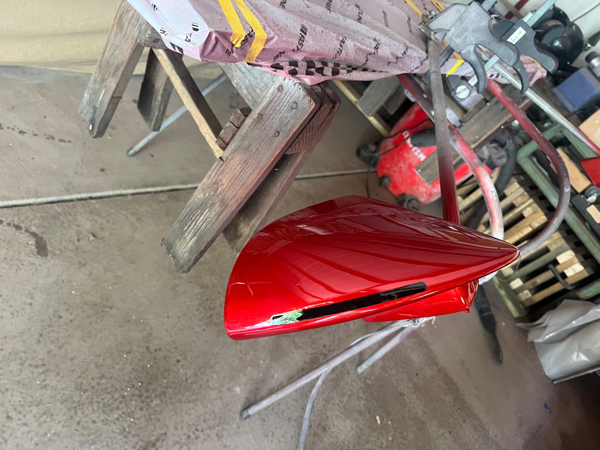

Re: Need help understanding front turn signal circuit
Project not finished yet but getting there. Side mirrors have finally been painted. I wasn't sure if the turn signal mod would actually turn out but they look awesome! Can't wait to get these mounted and functional.
You can see more info on how these were fabricated in my build thread HERE

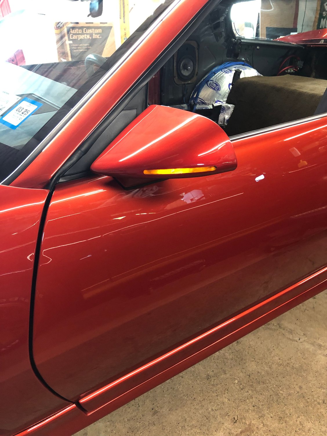

Mirrors installed and wired. They come on with the parking lights and blink with the turn signals / emergency flashers. Turned out pretty nice.
