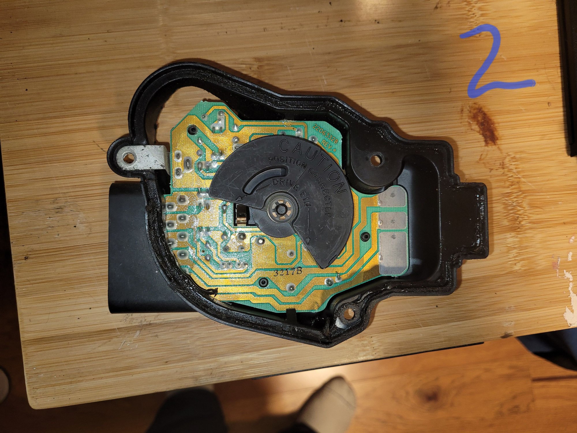

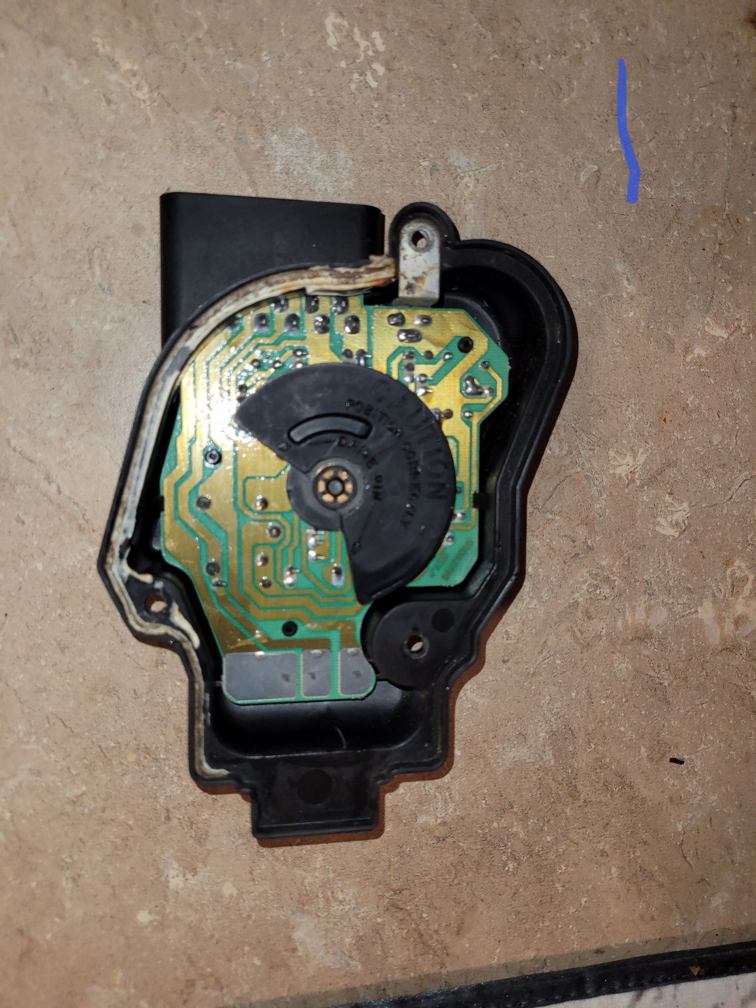

I need someone to push me in the right direction. I've got a 1990 camaro rs. It had a 2 speed wiper system with a non tilt wheel. The harness has cruise control but ive never known this car to have that feature, plus wires were cut. I had problems with the column so i replaced it with a refurbished ebay column for a 90-92 camaro. The new one has a tilt wheel with delay wipers. everything hooked up good. wire colors are matching on harness plug but wipers don't work as should. the delay setting does nothing. the hi setting wipers move maybe an inch. if i cut the mist setting on the wipers move full cycle. picture labeled 1 is the original module for the 2 speed wiper system. i tried picture 2 which came with a motor on ebay claiming to be delay wipers. no change. picture 3 i have no clue when or were i bought it but it does nothing. im looking for a picture of a confirmed delay wiper module so i can see what it looks like. is there anything im missing going from 2 speed to delay system? i know the multi switch could be faulty even though its refurbished, but sense those are a pain to get too, I want to get others opinions 1st.
